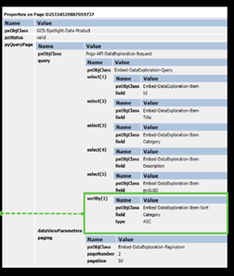

When a data page is sourced from a REST connector and advanced query options or Allow querying any column are enabled, Pega Platform does not handle filtering, sorting, or grouping. Instead, it passes a query structure (through pyQueryPage) to the REST connector. The external REST service must process these parameters and return the results; otherwise, the UI actions appear available but have no effect.

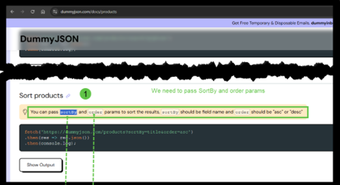

- Ensure that the REST endpoint supports query parameters for filtering and sorting (for example, sortBy, order). These parameters determine which field the data is sorted on and the sort direction (ascending or descending):

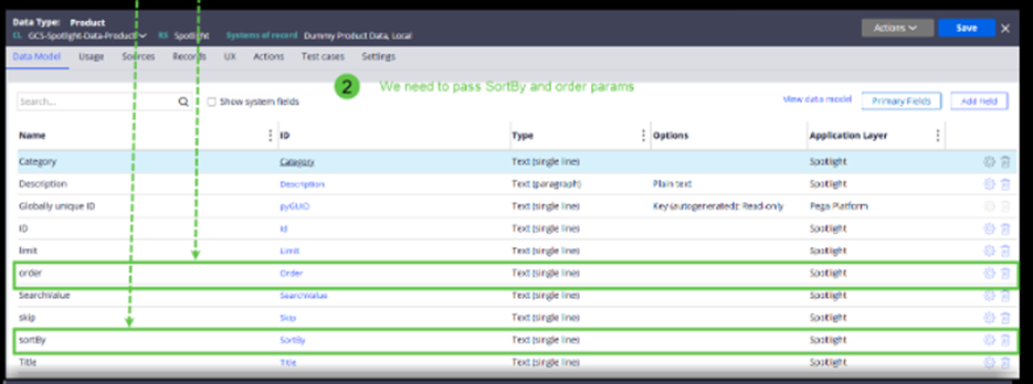

2. Define properties in the data or integration model to hold these parameters. These properties act as placeholders for values extracted from the platform-generated query structure and passed to the REST service.

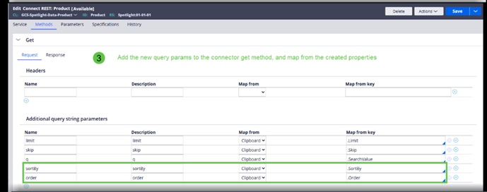

3. Map these properties to the REST connector request, as shown in the following image:

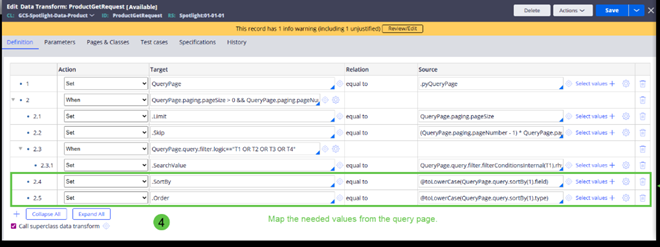

4. In the REST connector’s request data transform, extract filter and sort values from pyQueryPage. Then, assign the values to the mapped properties:
5. With the above configuration, the correct query parameters are passed to the REST service, the data page receives a pre‑filtered and sorted response, and the table renders the data correctly, allowing column sorting to work as expected.
