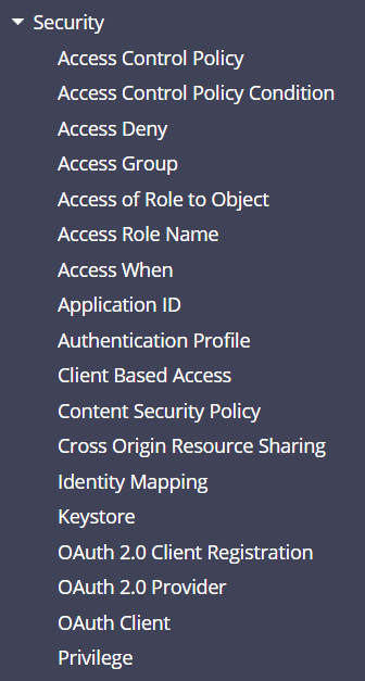

Thanks for your answer. I checked it, but not sure if you are looking at a different version of Pega? We are using Pega 24.1.2.
In the Records Explorer I only have the options "Records -> Security -> OAuth 2.0 Client Registration" and "Records -> Security -> OAuth 2.0 Provider". So we don't have for example the option "Records -> Security -> OAuth 2.0 -> Scope".
I also checked the records of "Records -> Security -> OAuth 2.0 Client Registration" and couldn't find a section to define scope in any of them. Therefore my question remains why/where is Pega adding "email" to the scope? Is this done by Pega somewhere in the background? (like the scope "app.alias.<AppName>" which I understand is needed/added by Pega)
