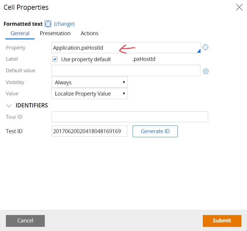

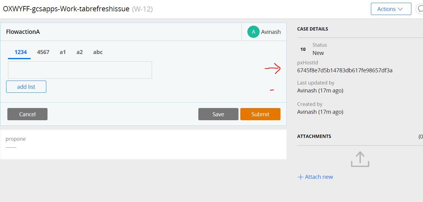

I have tried the below approach and I am able to populate the hostid , let me know if you can meet your requirement with the below approach

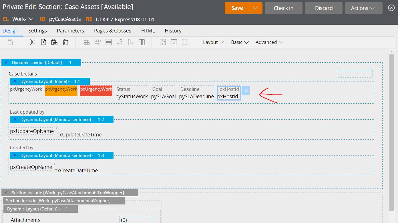

Open the below pyCaseAssets section and configure .pXHostId
cell properties for pxHostID

As the pyCaseAssets section is Available you can configure the Host ID where you find it suitable.
