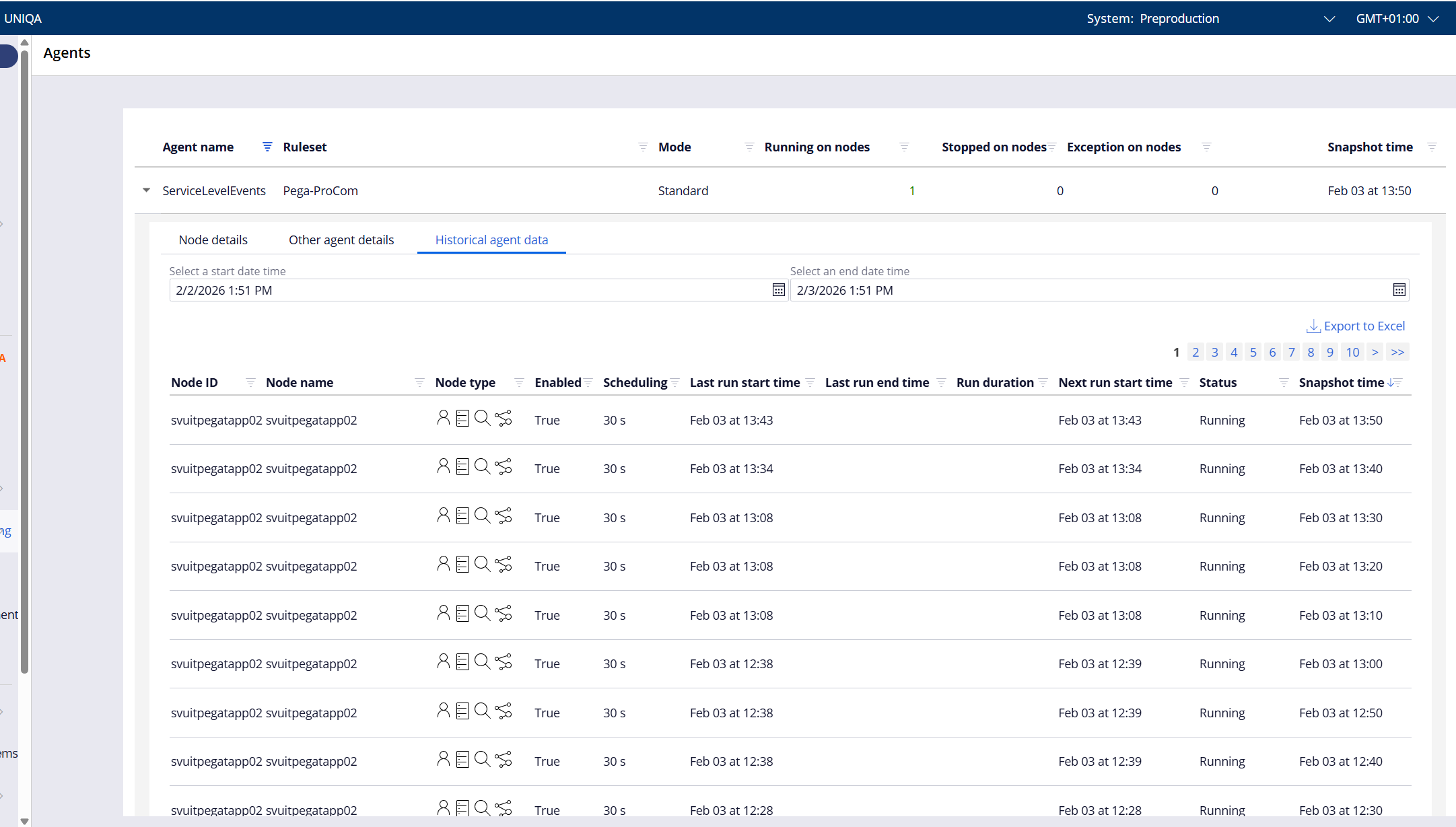

Using PDC we observe that the historical agent data show no values in last run end time and in run duration.
In comparison any other environment we checked (development, integration, production) has these values and no observed problem with the servicelevelevents agent.
