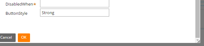

Hi Vinod,
I personally feel its not correct to have all fields made as mandatory fields.
However, i would suggest you following options:
1) SaveAs this control with some other name and make all fields as non mandatory except caption and action. and use that in your sections.
2) raise a SR for this for further analysis by Pega team.
I can see couple of sections using this control "pzOverlayButton " and not passing anything except caption and action, say for example Rule- pyOverlayTemplate at Pega-EndUserUI:07-10-17
Hello Vinod,
If you want to only change the style of the button to standard, just make the ButtonStyle parameter as Standard.

Hi Mounika,
I unable to change button style as standard because here so many required fields are there, could you help on that required fields.

Hi Ashish Agrawal,
I tried it its working, now i am able to change the button style as standard.
