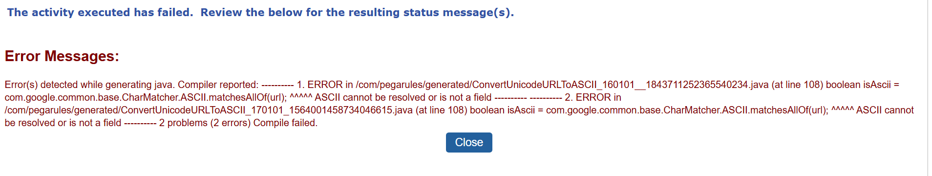

Error Description: While generating the Utilities library rule, an ASCII-related error is thrown. This is impacting all function rules that depend on this library.
The error message:

The error message:
Error(s) detected while generating java. Compiler reported: ---------- 1. ERROR in /com/pegarules/generated/ConvertUnicodeURLToASCII_160101__1843711252365540234.java (at line 108) boolean isAscii = com.google.common.base.CharMatcher.ASCII.matchesAllOf(url); ^^^^^ ASCII cannot be resolved or is not a field ---------- ---------- 2. ERROR in /com/pegarules/generated/ConvertUnicodeURLToASCII_170101_1564001458734046615.java (at line 108) boolean isAscii = com.google.common.base.CharMatcher.ASCII.matchesAllOf(url); ^^^^^ ASCII cannot be resolved or is not a field ---------- 2 problems (2 errors) Compile failed.
Root Cause:
The error originates from the following line of code in the ConvertUnicodeURLToASCII function:
-----"boolean isAscii = com.google.common.base.CharMatcher.ASCII.matchesAllOf(url); "
The method ASCII is no longer supported in the updated Guava package used in Pega 24. The correct method to use is:
----"boolean isAscii = com.google.common.base.CharMatcher.ascii().matchesAllOf(url); "
