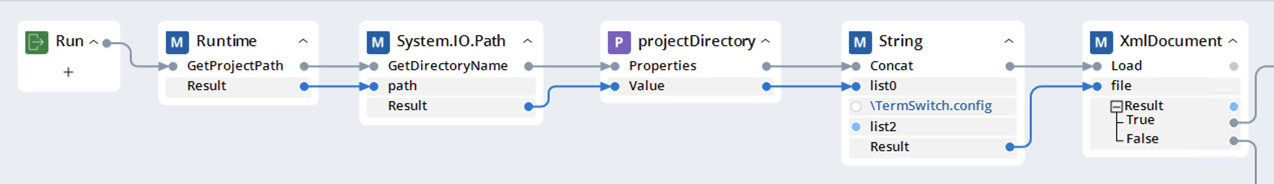

We deploy the project solution .pega file manually to a production NAS alongside other config files that are referenced by the automation. I have a module in the automation that gets the location for the currently running project and then uses that to locate the config file since the build and config are deployed to the same location. This worked well in v19.

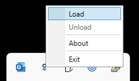

What's even more interesting is that, if I manually start the Runtime and manually load the project from the same NAS using the system tray, the pega runtime doesn't copy the solution .pega file to local AppData and actually runs entirely from the NAS. In this case, there are no issues and the automation runs as expected.
