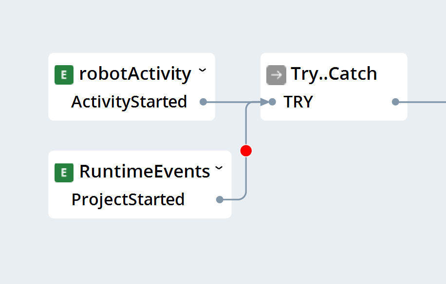

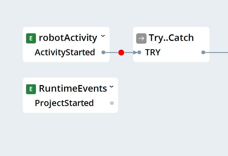

Currently, I’m using two events: RobotActivity and ProjectStarted. After completing my testing in Studio, I delete the connector with the breakpoint from the first screenshot. So, when I deploy the code, it gets triggered via the RobotActivity event.

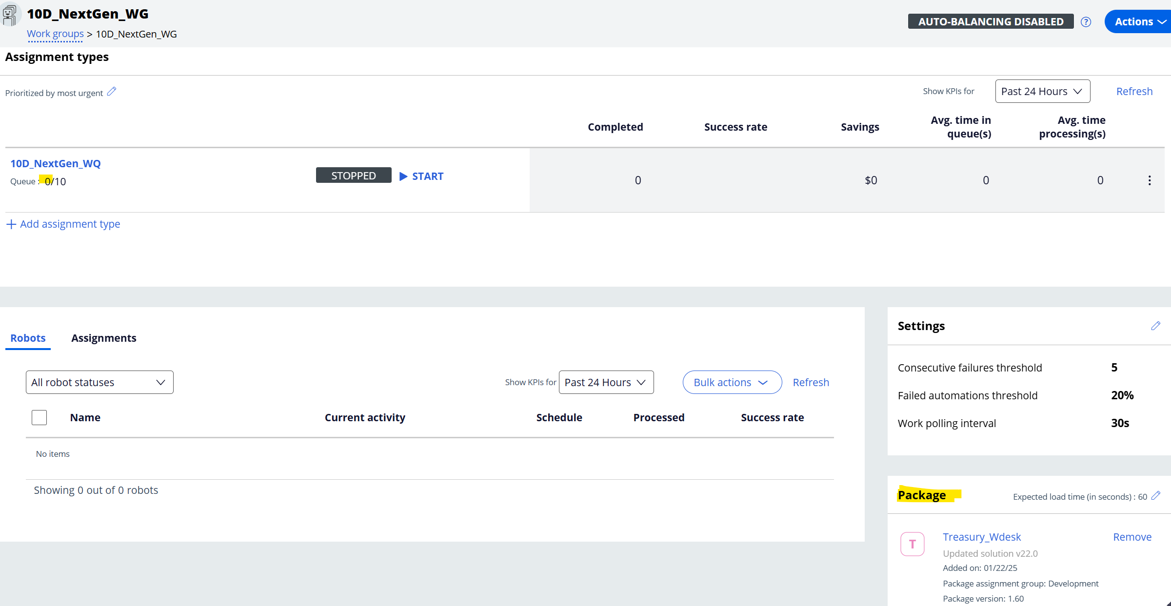

The issue I’m facing is that when I configure a bot in Robot Manager, it always picks up the package deployed and assigned to the workgroup (as shown in the screenshot below). I feel like I might be missing some configuration that would allow Studio to directly pick up a case from the workgroup, so that it halts at the breakpoint in the RobotActivity event, as intended.

If you setup your automations this way, then the only thing you need to test from your Pega case, is if you've correctly hooked up your input and output parameters (and if the event fires at all). I don't believe that you can get Studio to register with Robot Manager to allow you to test it as if it were an unattended bot. You could do this with the Runtime in Studio, but at that point, it might just be easier to deploy it to your test bot and test there.
By setting up your automations in this way, you ensure that the bulk of you testing and debugging is done on the automations themselves and does not need to rely on registering a bot and then assigning it work and then waiting for that work to come to the queue and be passed to the bot, etc.
If you configure your machine as if it were an unattended bot (i.e. setting up the RegsitrationOperator and Windows User in the credential manager), then you could launch Runtime from your installation directory and it would register, but then you wouldn't be able to use the debugger in Studio. You can however load the log file from Runtime into Studio and step through it as if it were running.
