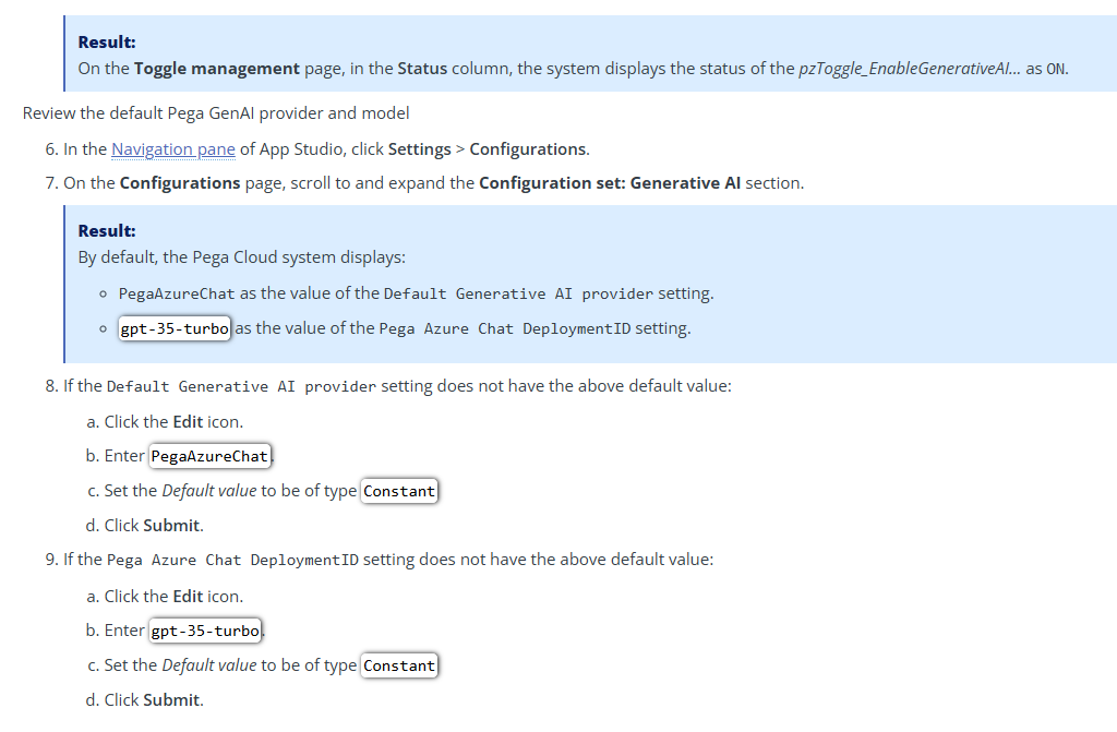

how does turning on Generative AI toggle in Pega 23.1.3 help ? Is any data sent to another cloud provider.
Right now, the default GenAI provider is PegaAzureChat.

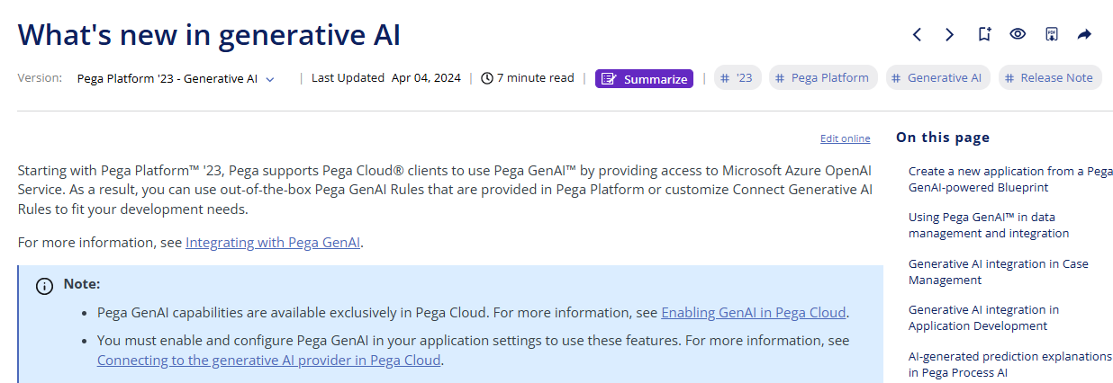

Currently, Microsoft Azure OpenAI Service is the only GenAI cloud provider that Pega uses with the PegaAzureChat implementation. The documentation doesn't mention any alternative GenAI cloud providers being supported or available for use with Pega's GenAI capabilities.
What's new in generative AI
Connecting to the generative AI provider in Pega Cloud
Pegasystems Inc. does not authorize using Pega GenAI outside Pega Cloud. Any unauthorized configuration of Pega GenAI outside Pega Cloud is not supported by Pega and should be expected to stop working in future versions of Pega Platform.
