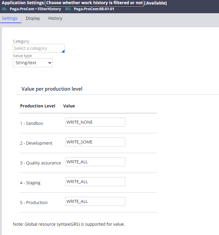

  Aaseya IT Services Pvt Ltd
Please check your environment Production level and the corresponding value, this may be causing the issue.
