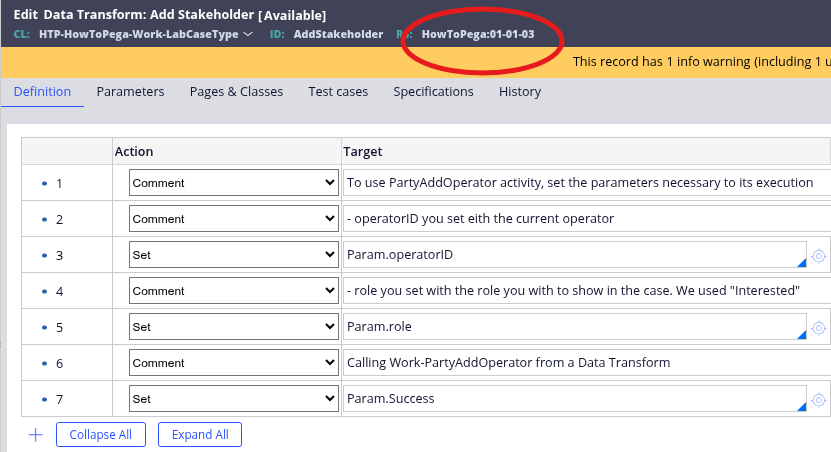

Step 1: Understand the Initial Scenario

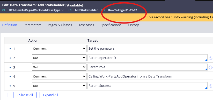

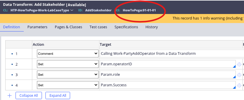

Before starting, it's important to see the current state of the rules. In our example, we have a rule (a Data Transform named `AddStakeholder`) that has been saved multiple times, creating three distinct patch versions within the same ruleset, `HowToPega:01-01`.
- Version 01-01-01
A rule named AddStakeholder in ruleset version 01-01-01
- Version 01-01-02
The same rule, AddStakeholder, in ruleset version 01-01-02
- Version 01-01-03 (the highest)
The same rule, AddStakeholder, in ruleset version 01-01-03
The goal of skimming is to create a new ruleset version that contains only the highest version (01-01-03)
of this rule and all other rules within the specified version range.

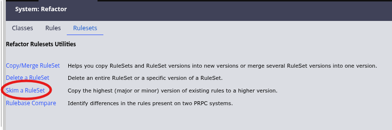

From the Pega navigation panel, access the ruleset refactoring tool.
- Path: Configure → System → Refactor → Rulesets
- On the "Refactor Rulesets Utilities" screen, click the Skim a RuleSet option.

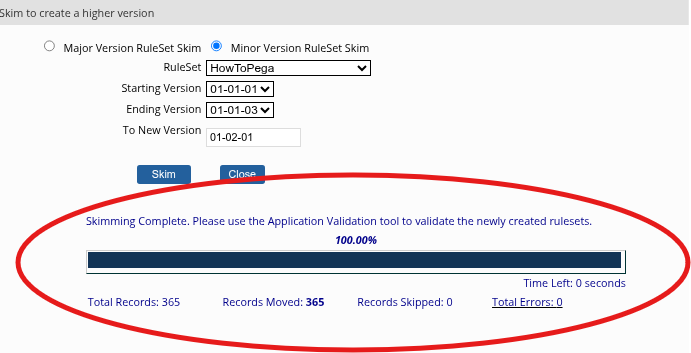

Step 3: Configure and Run the Skim

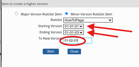

The "Skim to create a higher version" dialog will appear. Here, you will define the operation's parameters.
- Select the Skim Type: Choose between "Major" or "Minor." For this guide, we select Minor
- Version RuleSet Skim.
- Select the RuleSet: Choose the ruleset you wish to optimize (in our case, HowToPega).
- Define the Version Range:
- Starting Version: The first version to be included (e.g., 01-01-01).
- Ending Version: The last version to be included (e.g., 01-01-03).
- Confirm the New Version: The system will suggest the new ruleset version. For a minor skim of
- 01-01-xx, the suggestion will be 01-02-01.
- Click Skim to start the process.
The Skim configuration window showing a Minor Version Skim from 01-01-01 to 01-01-03, creating new version 01-02-01
Step 4: Analyze the Skim Result

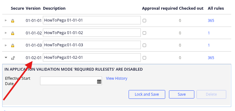

The process is typically very fast. Upon completion, a confirmation screen will display a summary of the operation, showing how many records were moved.
If you now check the list of versions for your ruleset, you will see the new `01-02-01` version has been successfully created. It contains a copy of the highest version of every rule from the range you specified.

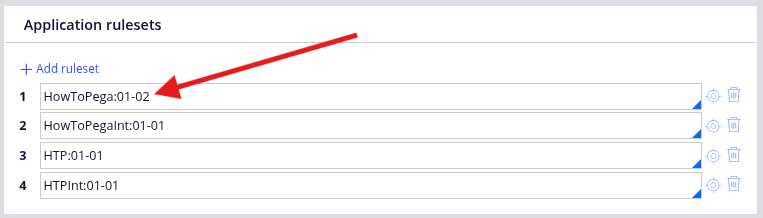

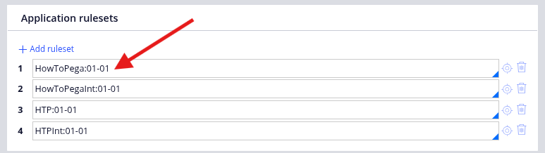

Step 5: Update the Ruleset Version in the Application
Your application is still pointing to the old ruleset version. You must update it to use the new, optimized version.
- Navigate to your application definition.
- In the "Application rulesets" list, find the ruleset you just skimmed.
The application rulesets list showing the old version, HowToPega:01-01
- Update the version number to the new one that was created (from 01-01 to 01-02).
The application rulesets list showing the updated version, HowToPega:01-02
- Save the application definition.

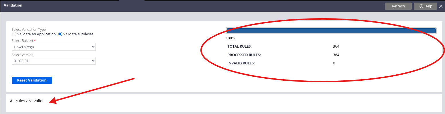

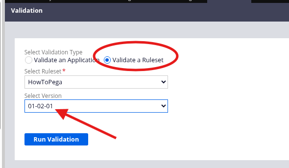

Step 6: Validate the New Ruleset
The skim completion message recommends using the **Application Validation tool**. This is a fundamental quality assurance step. The tool verifies that all rules in the new ruleset version are valid and can be executed without issues.
- Path: Configure → Application → Tools → Validation
- On the validation screen:
- Select Validate a Ruleset.
- Choose the RuleSet (HowToPega).
- Select the Version you just created (01-02-01).
- Click Run Validation.
The Validation tool configured to validate the new ruleset version 01-02-01
The tool will analyze all rules and present a result. A result with zero "Invalid Rules" confirms that your skim was successful and the new ruleset is healthy.
