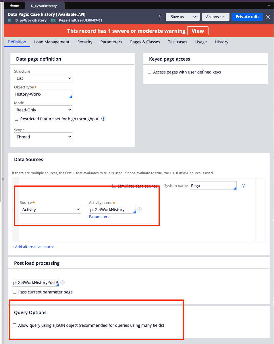

The built-in 'Export to Excel' functionality in Constellation is a powerful feature, but it only works for queryable data pages. This requires the data page to be sourced by either a Report Definition or a Connector Rule. By default, the case history data page, D_pyWorkHistory, is not queryable because it uses an activity to determine which report to run.

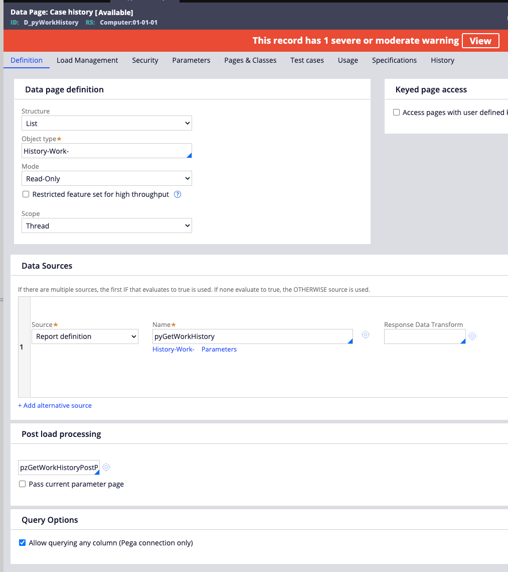

Step 1: Make D_pyWorkHistory Queryable
Open the
D_pyWorkHistorydata page. -
Save it into your application ruleset. This creates a new version you can edit.
Change the source of the data page from "Activity" to "Report Definition."
Specify the Report Definition that the original activity was calling. This is typically
pyGetWorkHistoryorpyGetWorkHistoryWithLatLong(depending on whether geolocation is enabled for your case type). See activity pzGetWorkHistory for more details -
Pass the parameters of the data page to the Report Definition by checking the 'Pass current parameter page' box in the Report Definition parameters section.

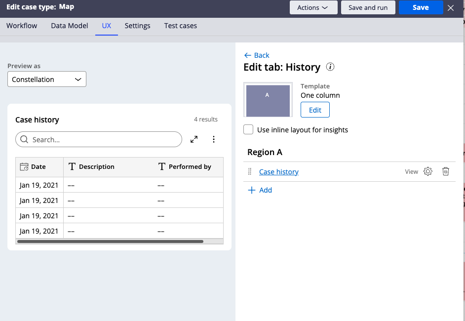

Step 2: Update the Case History View
Open one of your cases and navigate to the history view.
Make a small change to the view, such as moving a field back and forth or checking / unchecking a setting. This action forces Pega to save the view.
Save the view. This ensures it uses the newly updated, queryable data page from your application ruleset.
