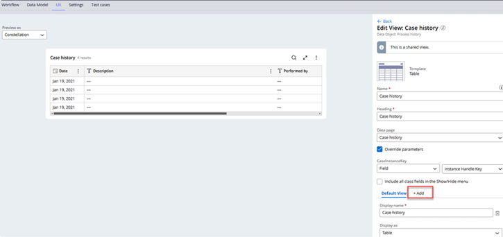

- Navigate to the UX tab of your desired case type
- Open the History Tab
- Open your History View
- Add or Edit the existing view
- It is recommended to keep both the full Audit History and to create a new view for the refined Narrative. This will allow deeper dives of the full history to be conducted as needed.
- Configure this view as per the business requirements
- In this example we have:
- Display As = Timeline
- Date field = Time
- Title = Message Key
- Add filters for important events
- In our example, we filter for two events, but you can configure as per your business requirements
- Save and run your case
- Constellation apps allow switching between “table” views via the drop down
- A filtered view is displayed
