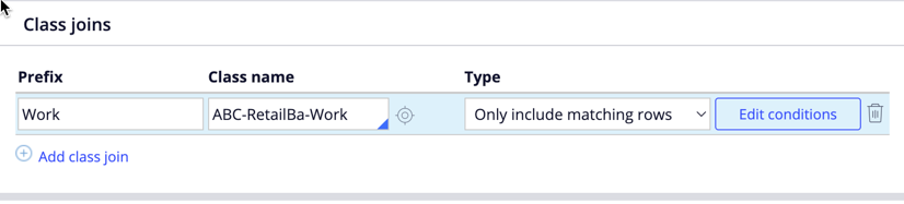

Step 1: Create an association rule Assign-WorkBasket and Work table

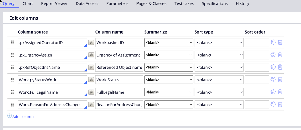

Step 2: Configure the necessary properties in the Report Definition (as shown in the screenshot below)
Step 3: Configure the authoring in the View to display properties from both the Work table and the Assign-WorkBasket.

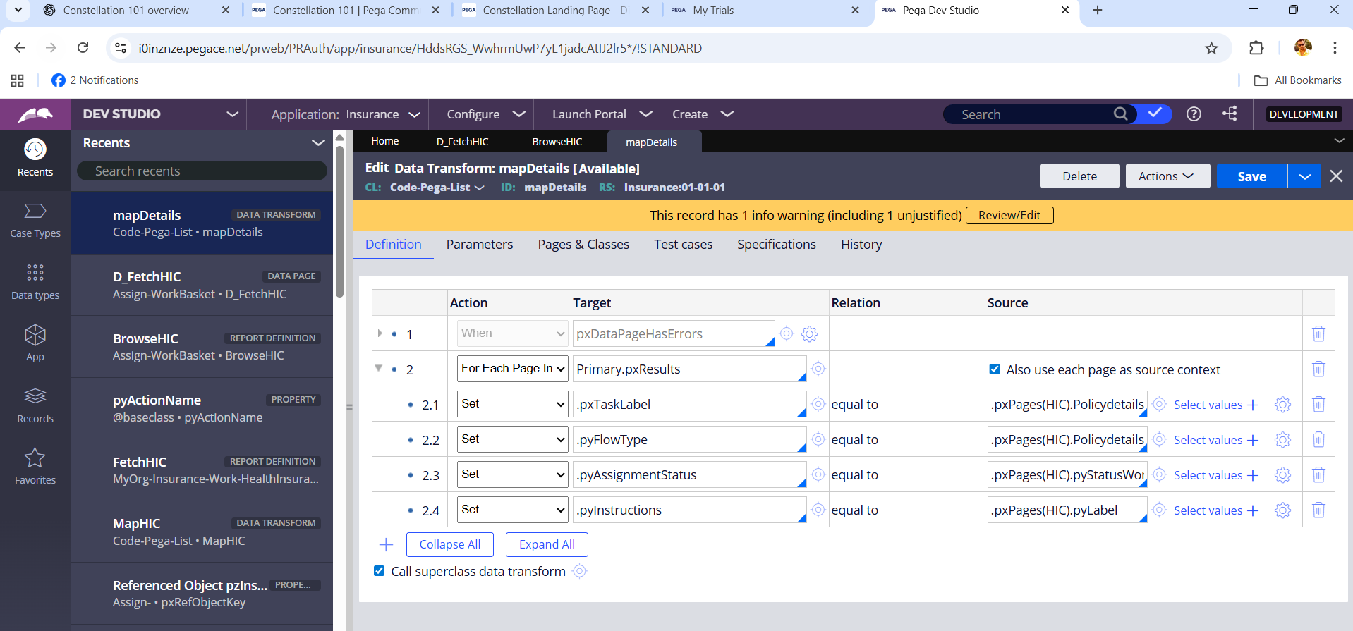

To address this limitation in Constellation, the alternative approach is to use Response Data Transforms,
Step 1: Start by creating a report definition in the Assign-WorkBasket class. In this report, set up a join with the Work table. This configuration enables you to fetch relevant fields from both tables in a consolidated report, as demonstrated in the screenshot provided.

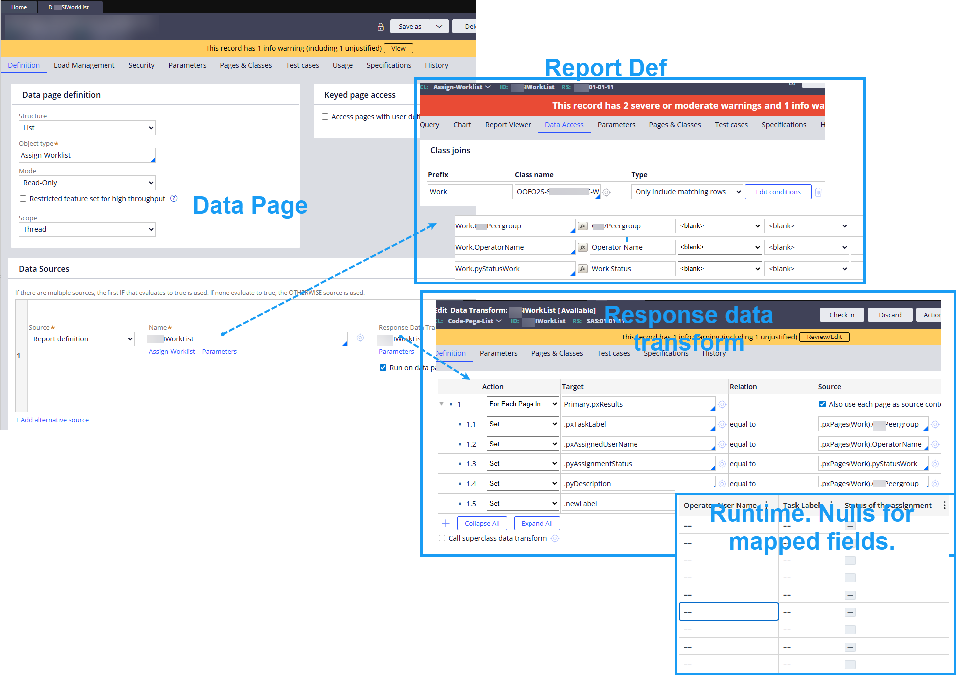

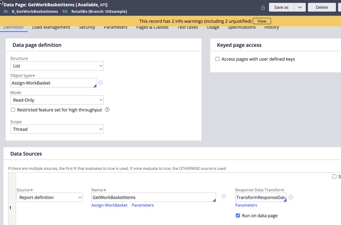

Step 2: After the report is set up, create a data page that uses this report definition as its data source. The data page acts as a channel to retrieve and structure the combined data, making it accessible throughout your application. At this stage, you should also create a Response Data Transform, which will process the data once it is retrieved.

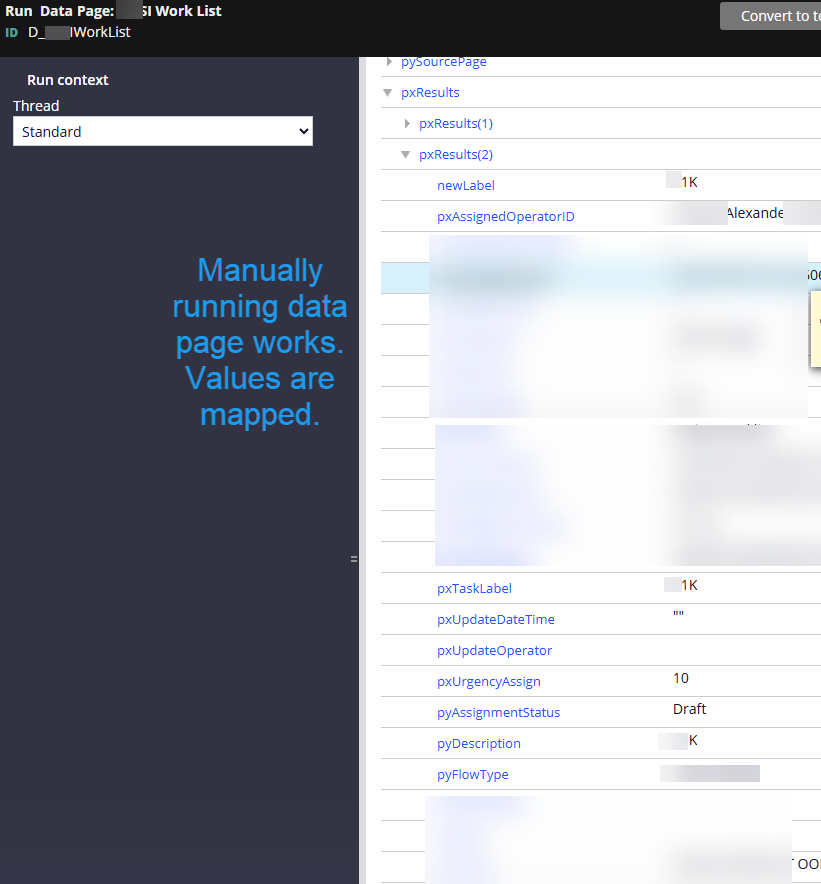

Step 3: Within the Response Data Transform, carefully map the properties pulled from the joined report to the corresponding properties in your application. This ensures that data from both the Assign-WorkBasket and Work tables is accurately assigned and readily available for display in the user interface. Visual guidance for this mapping is available in the screenshot below.

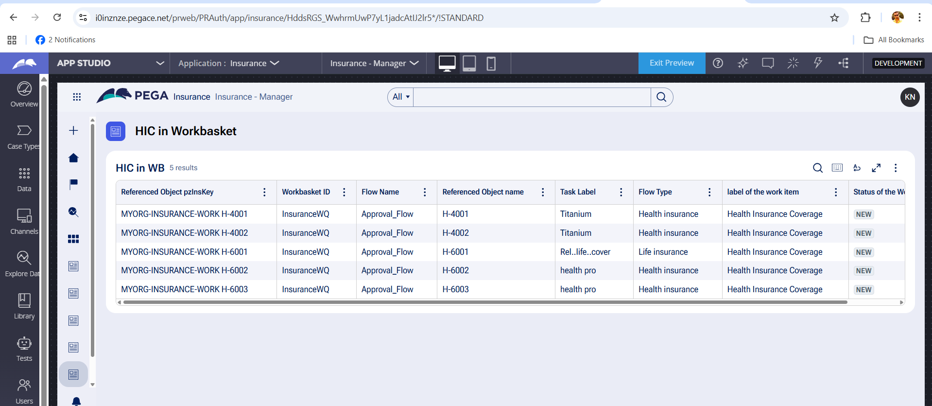

Step 4: Proceed to create a landing page in your application, and configure it to use the Data Page you have just set up. This landing page will serve as the main interface where users can view the consolidated information.
Step 5: Finally, configure the columns on the landing page to display the specific fields and data points that are most relevant for your users. This customization helps ensure that the information is presented in a clear and user-friendly manner.

@RameshSangili: Does the column filter work correctly for the properties set via Data transform ? I believe when we apply column filter its running against the report definition .
In above ex: if we apply column filter for "pyAssignmentStatus" not equal to "Resolved-Cancelled" , then the values would still be set via Data Transform and it would show up in the table ?
