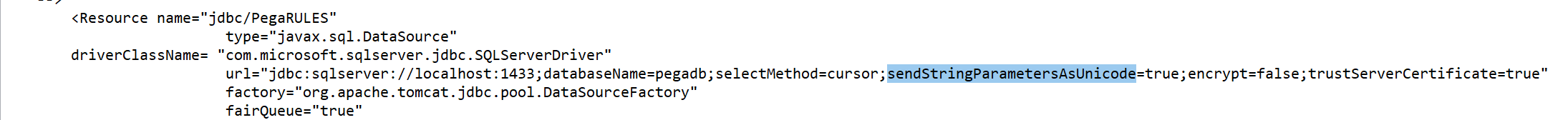

1. Include sendStringParametersAsUnicode=true in your JDBC connection URL.
