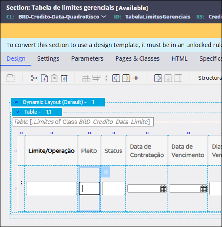

- Configure by using Show SmartInfo on a table cell.
- Set the trigger event to Hover (onmouseover).
- Hover over the table cell in the Theme Cosmos portal. Observe that the SmartInfo popup does not appear.

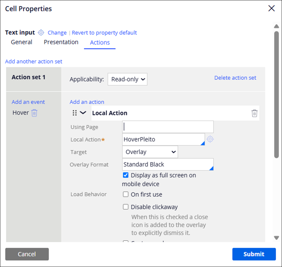

- Remove the Show SmartInfo action from the table cell's action set.
- Create a Local Action that references the business information section and set it to display as tooltip.
- Configure the Local Action for overlay rendering by adding the parameter
mdcTarget=actertiaryin navigation actions.
- Associate the Local Action with the table cell and set the trigger to Hover.

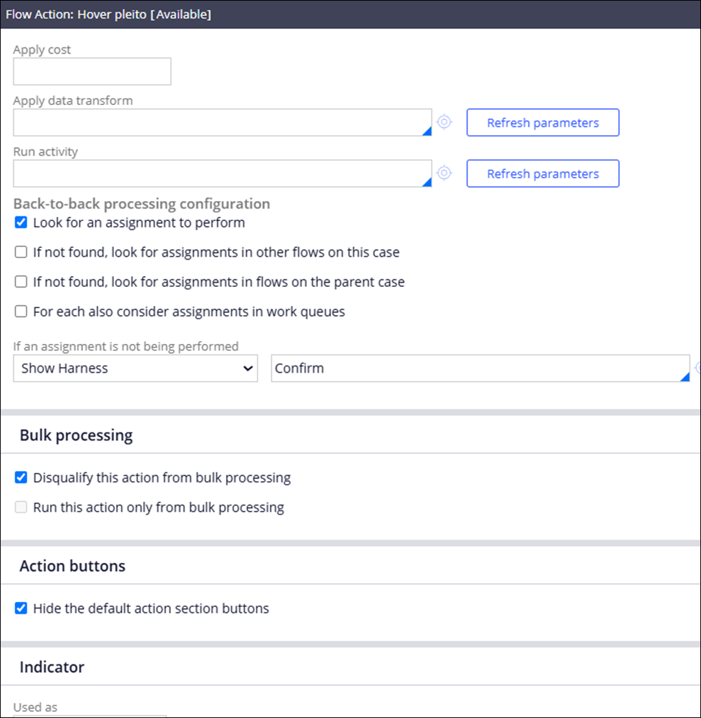

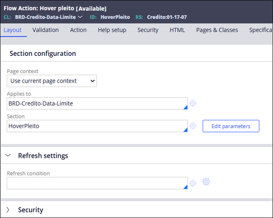

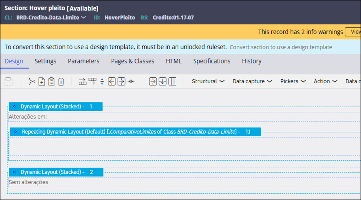

The following configuration images show the Flow Action and the section used by the Local Action.

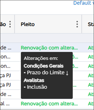

After the configuration, hovering over the table cell displays the tooltip with the relevant business information.
