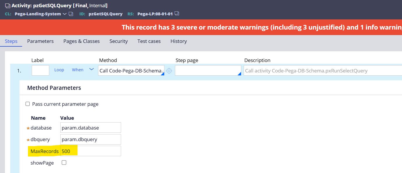

Hi @Bhavana_S
Thanks for sharing,
I think Not Required Report definition or BIX Extract.
We can get it from the Query Runner itself with some small changes in the OOTB rule.
By doing the private edit on this activity, pzGetSQLQuery, and updating the max records, you will get maximum records, from 0 to 30k
I hope this will help you.
