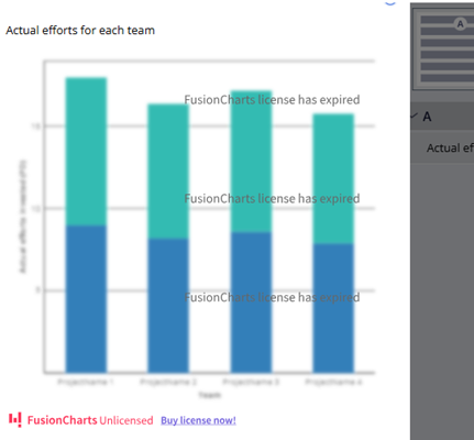

Users are unable to view reporting charts or widgets and have lost reporting functions. Output charts are blurred displaying water mark with an error. This issue occurs for users using legacy FusionCharts reporting after updating to Pega Infinity 25.
Symptoms and Impact
Error
FusionCharts license has expired.
