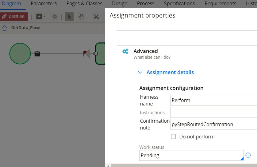

I created a flow and saw a flag icon after the start shape. What does that flag indicate

That flag denotes the work status defined on the assignment the connector is going into. There are different flags for different status. Red for Pending, Blue for Open, Checker for Resolved.

PFA screen shot.

Thanks for sharing the screenshot. Attach the screenshot of the connector property.

Refer the below screenshot to look for the Assignment's setting.
For knowledge share, below icon appears if properties are set or datatransform is applied on the connector.

Hi Goutham,
Where can i get more information about this, What does green flag indicate?
Virtusa Consulting Services Pvt. Ltd.
Please refer to 'Assignment Details' section in this below link
https://community.pega.com/sites/default/files/help_v719/procomhelpmain.htm.
And, Green flag comes when status is 'New'
