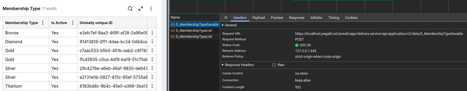

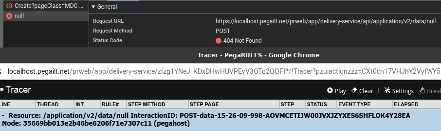

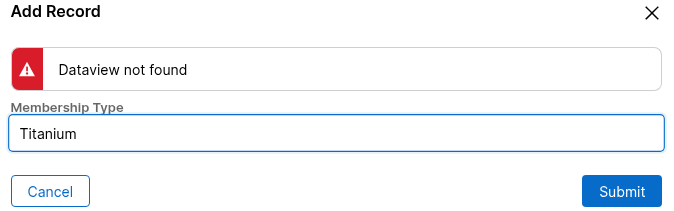

View Id has not been set in resource parameter of /application/v2/data/null service so dataview not found error appear.
Hello dears,
Whenever I try to create a record for membership type data object, I am getting error on the screen below.
What could be the reason?
Regards.
Mert.
