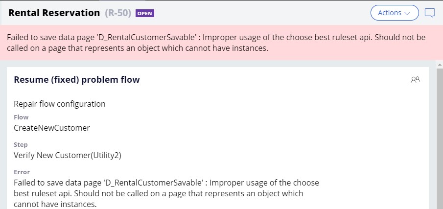

Hi, the data are not being saved. Additionally, I can navigate to the following error in the Actions dropdown. I hope someone explains how to fix it.
xusheng liang Shubham Patil
CGI
I had the exact same error message (Improper usage of the choose best ruleset api [..])
The cause was that my RentalCustomer data type was created on the wrong level (that is my guess anyway - I am new to Pega). I could see the data type in App Studio with the Case Type on the Data Model tab but not under Data or in Dev Studio under Data types.
So to fix it I made a new datatype Customer directly from Data and repeated all steps up from US-104 replacing RentalCustomer with Customer.
As noted before it is also crucial to have all properties directly under (Rental)Customer. Only the view is divided in sections not the data type itself. (US-104)
