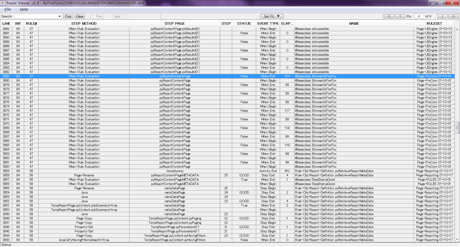

Now I am facing low performance of report display.
By tracing, DB performance seems not bad, it took Display rendering.
And found some delay had come from some When rule. On of example is @BrowserIsFireFox (tool).
The report has 11 properties for 1345 rows, all optimized, 3 items used by sort parameter. I have tested it IE11, FireFox v.43.04
The trace was collected by FireFox v43.04 and we can see it "false" as the result of When rule.
I would like to know how we can stop or make it faster, the when rule (@BrowserIsFireFox) for rendering performance.
@BrowserIsFireFox function checks simply browser type around 100-300 ms but the Report activity seems to call this function times of number of properties.

I know this would not take big parts of performance (see attached), indeed. But I wonder still asking browser version,
And we know low performance comes a lot of stacks of these small actions.
