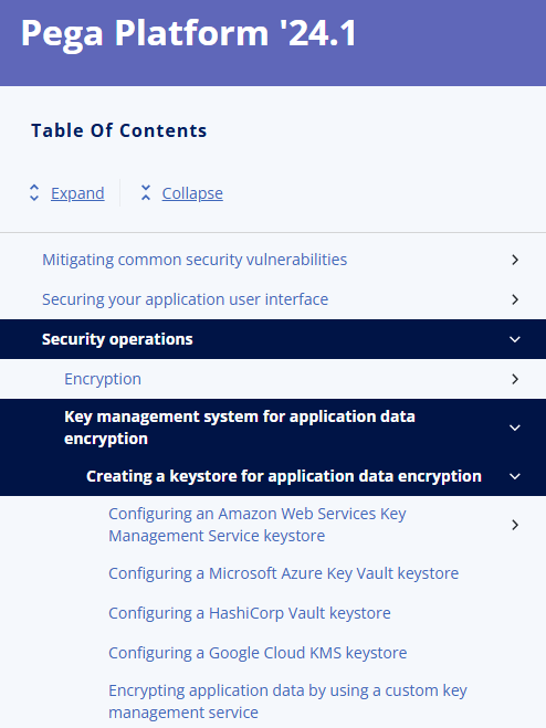

- I’ve created a GetCustomMccmMasterKey activity under Data-Admin-Security-Keystore class.
I am getting “Failed to add keystore to cache error” message after executing activity. Is there any way to successfully add keystore to cache and get this issue resolved?
I’ve also created a data page described in second step of the document in link below. However, we should resolve the activity error issue first to move further steps.
References
Encrypting application data by using a custom key management service (pega.com)
