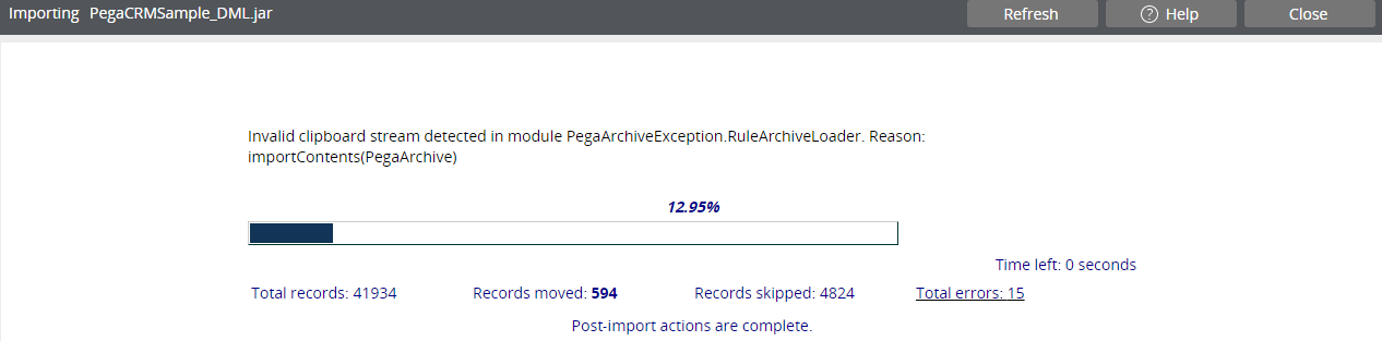

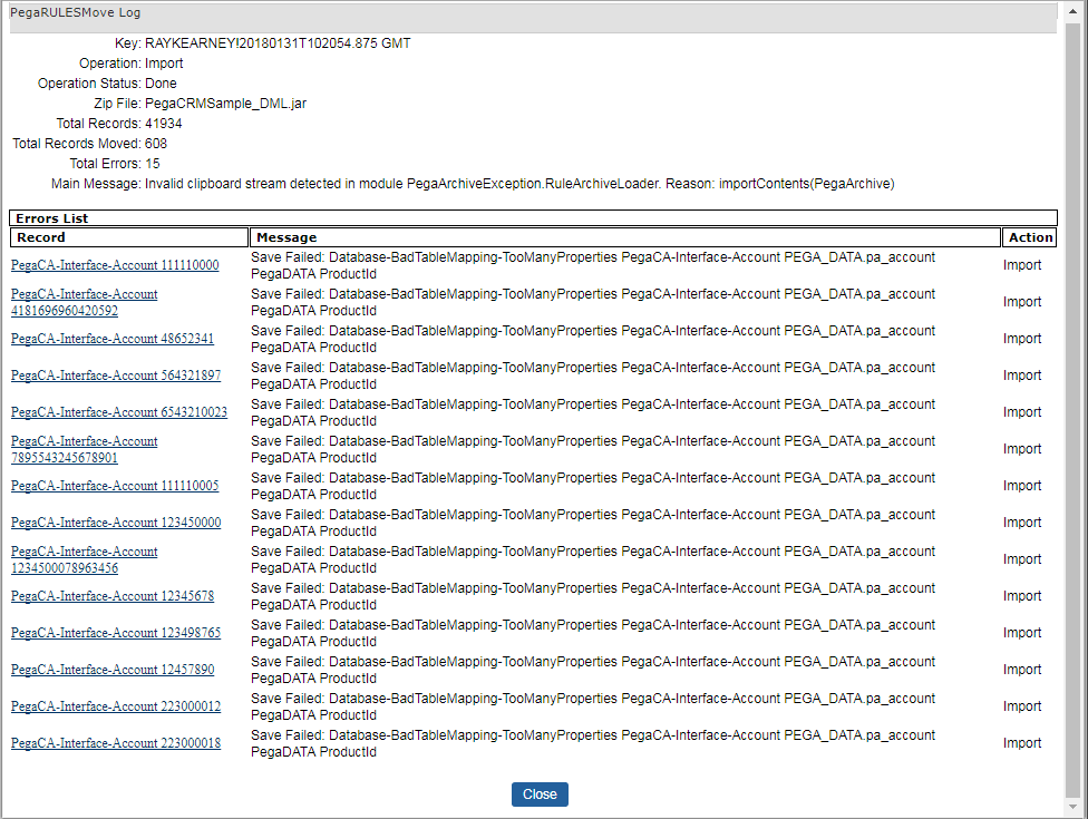

When importing the .jar file PegaCRMSample_DML the process stops at 12.95% with the above error and 15 errors in total, screen captures attached show this.
