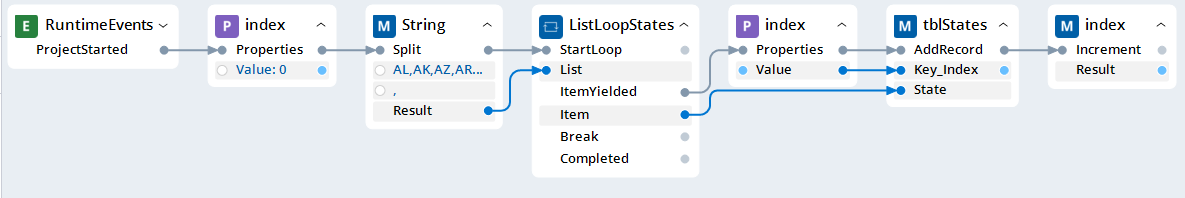

@ThomasSasnett So I tried playing around with your solution but may not fully understand how it works. Here is a screenshot of what I have going on but not sure how to pass the selected index to be the key to the lookup table nor how to get it to pull the value.
@JahriC17390650Let me make sure I understand your problem. As I understand it, you have a combo box on a PDF that has a preset amount of values in it. As of now, you can only retrieve the selected index from that combo box instead of the selected value. When you wish to retrieve data from the PDF, you need to translate that index value to the actual value. If that is accurate, here is what you are missing.
- You need to first populate the table off of the ProjectStarted event. Your table would have two columns; the Index (which would be the selected index from the combo box), and the Value (which would be the value that the selected index would translate to).
- Now that you have a table with the values populated, you can use the GetRecord to translate whatever the Selected Index is from your PDF into the actual value. You would call this after you had extracted the data from your PDF.
Does that make sense?

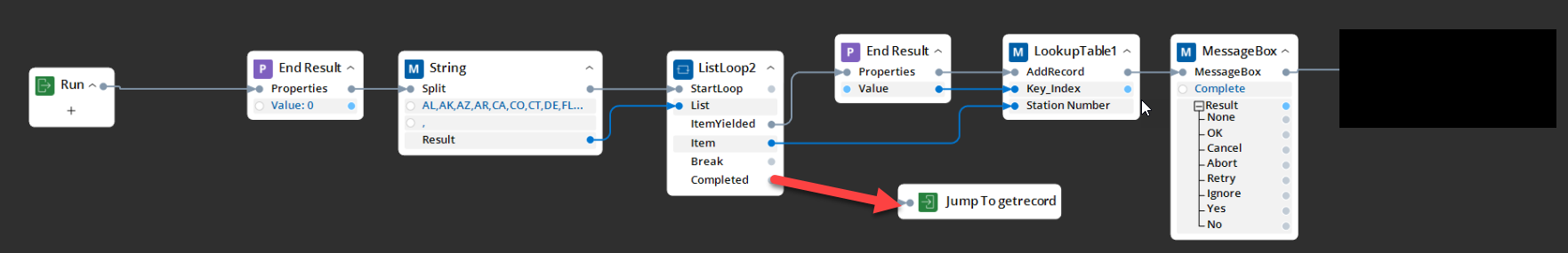

@ThomasSasnett So I'm trying to playa round with it to understand how to use it properly and am still a bit confused. I attempted to hard code a specific index to see if the desired result would pop up but it shows up empty and then repeats while incrementing through each state. Where am I getting this wrong?
@JahriC17390650 You are trying to do this in a single part. You need one automation that populates the table. After the table has finished populating (in your case after ListLoop2 has completed), you can then get a value out of it. You are trying to get value 45 out of the table before it has been added to the table. Add everything to the table first and then use the Completed execution path out of ListLoop2 to call GetRecord.

@ThomasSasnettSo I broken up the automation some and it does loop through the values but I'm hoping that when I place ten as the key index it would just populate GA since its the tenth entry. I appreciate your patience and help with this. i know these are amateur issues.
I also tried using the completed method from listloop2 and calling get record but same results
@JahriC17390650You are still inside of the loop when you are jumping to GetRecord. You must use the Completed execution path off of ListLoop2 to jump to GetRecord. ListLoop2 is adding all of the states to the table. From where you are jumping to GetRecord, you only have the one state you saw in your message box in the table. You need to add them all first.

@ThomasSasnett understood. When I do that it just gives me the complete message 50 times.
@JahriC17390650Right. You don't need a message box there. ListLoop2 is iterating over each of the fifty states and adding each one (one at a time) to the lookup table. Your Jump Label is then accessing one of the 50 states that have been added to the table after all 50 have been added.
@ThomasSasnett This is why you want these in two separate automations. The part with ListLoop2 would be called from the ProjectStarted event since it only needs to be done once. Whenever you then read from your PDF later, that event would trigger whatever steps are involved in reading the PDF and then you'd be able to retrieve a value from the table since it was already fully populated on startup.
