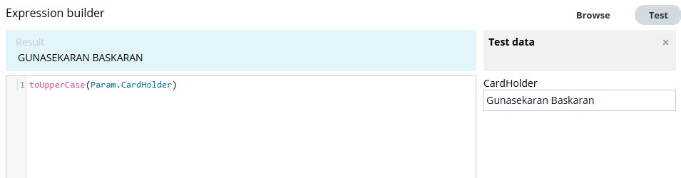

@Satya K
You could make use of toUpperCase Pega OOTB function to convert needed values to Upper Case format. Attached screenshot for reference.
