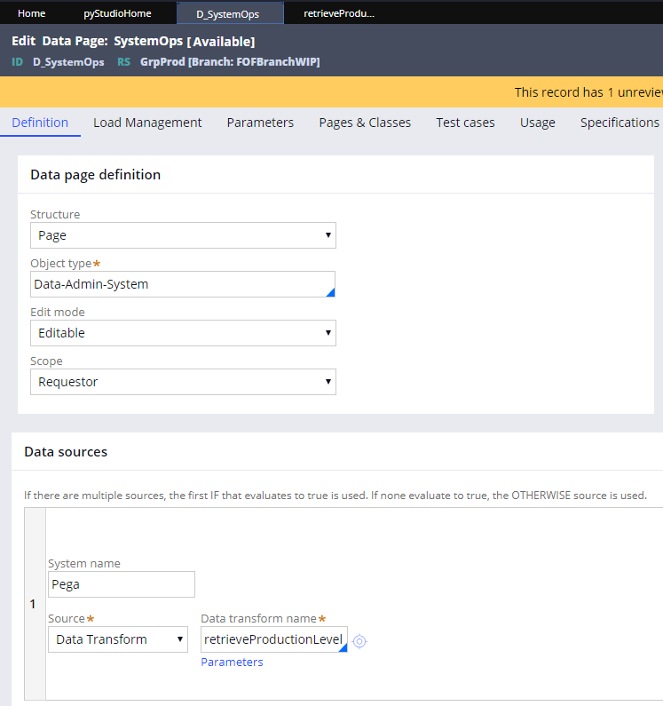

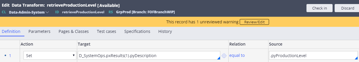

Im trying to reference the production level of the system in order to hide the guardrails that appear when you load into the system and some other areas of the system through a condition but I can't seem to get the actual value to be passed over. Here is the data transform
and Im using this DT in a data page like so.

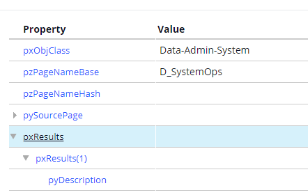

Whenever I run this data page however my results are always blank even though I know that the production level is 3
I'd appreciate any help to know what I'm doing wrong as I'm fairly new to PEGA so any guidance is very much appreciated.
