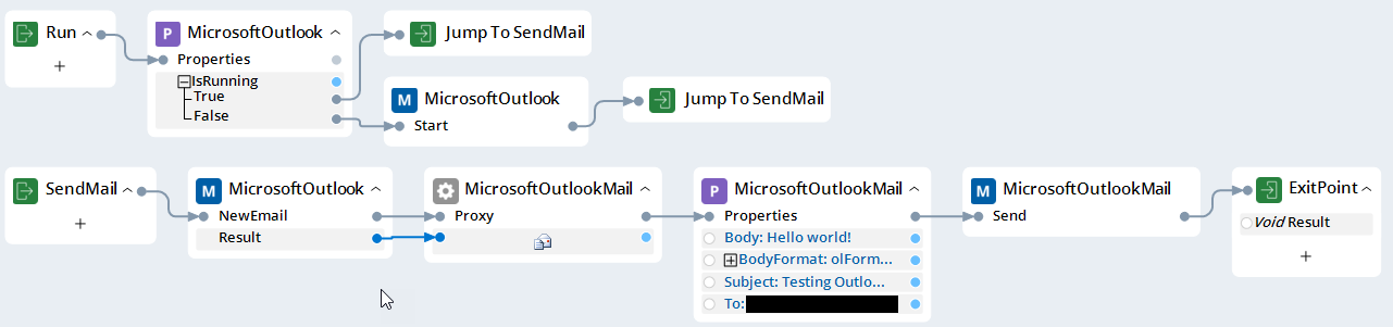

@SrinivasR3193 The connector needs to be started. StartOnProjectStart should be true. You may also use the Start method on the connector to start it if it isn't running. I suspect there is something simple you are missing. Without seeing either a log or more details, I can't really offer many suggestions. Are you able to share the full error message you are getting? Are you certain you are setting the email properties properly? The NewEmail method returns a Mail object, so you'll need to extract a proxy (or simply drag the blue dot from the Result data point) to access the properties and the Send methods of that object. For screenshot clarity purposes, I used a proxy, but you can also just drag out the blue dot and access the properties and Send method from there.

@ThomasSasnett i updated my automation to same as above and still getting the same error.
