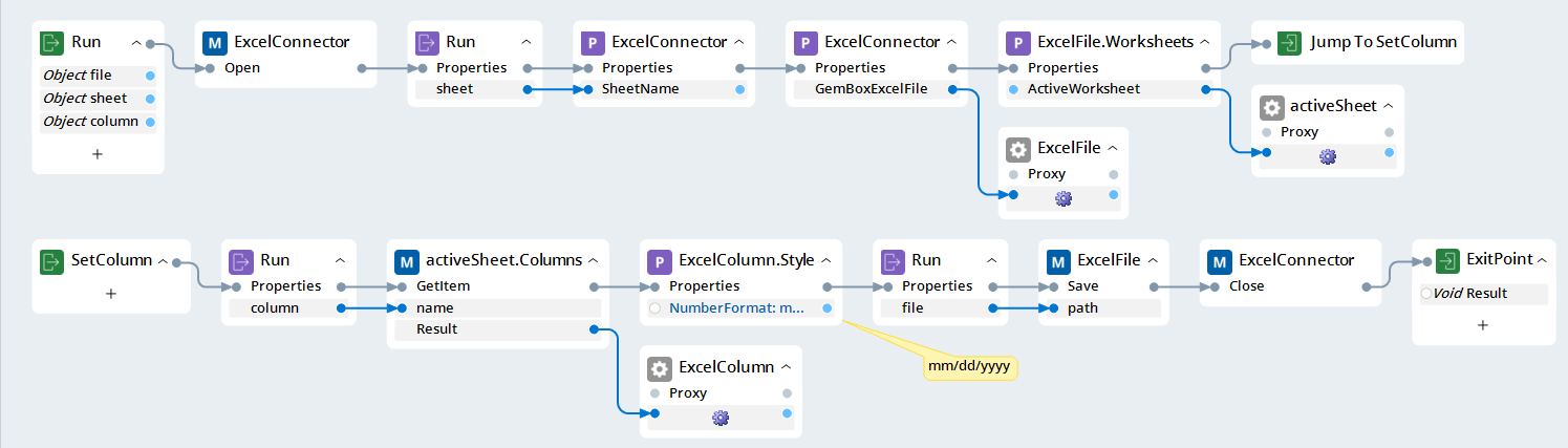

How to change the entire column format in excel - Pega RPA
I need to change the date format in Excel from DateTime to Date. Is there a way to change the entire column instead of looping through each row? I tried Setcellformat but it only works for one cell and if I set it to "A:A" gives an invalid address error.
