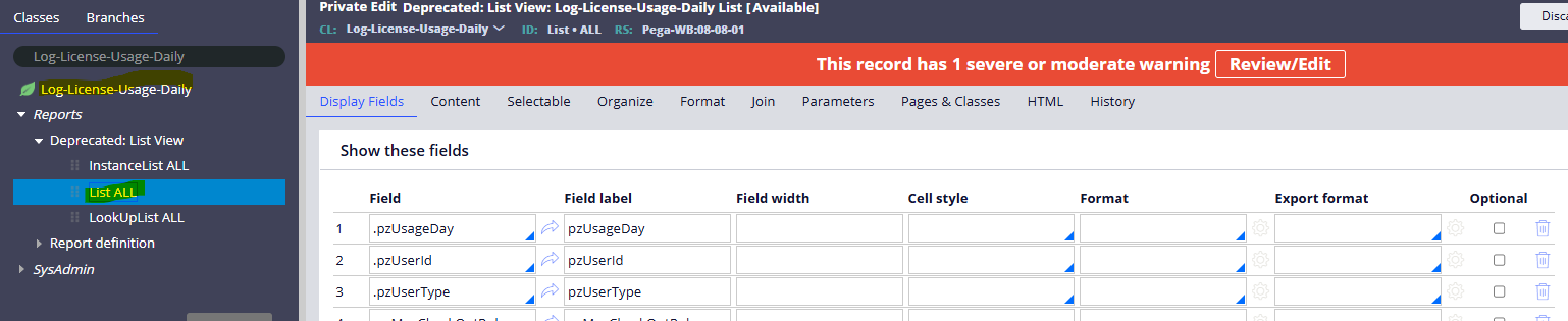

@DEBASMITA you can refer to the list view List ALL (similar to a report def in older version) in the class Log-License-Usage-Daily:

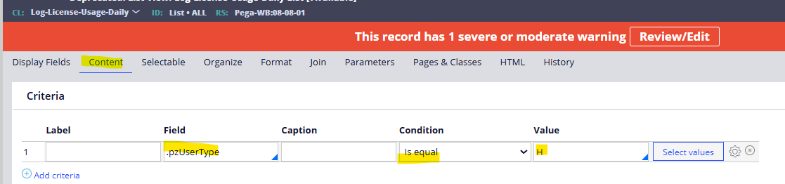

You have to do a private edit on this report to add the filter pzUserType=H to retreive the usage of operators:
