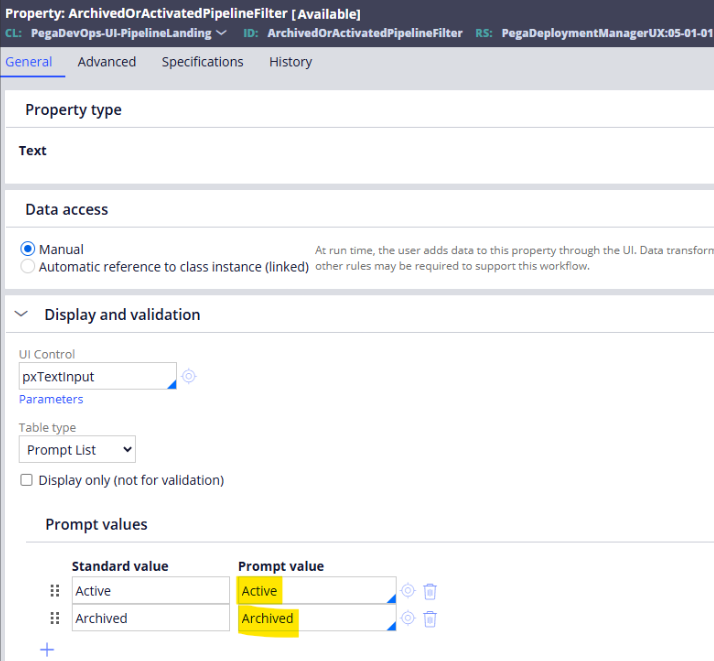

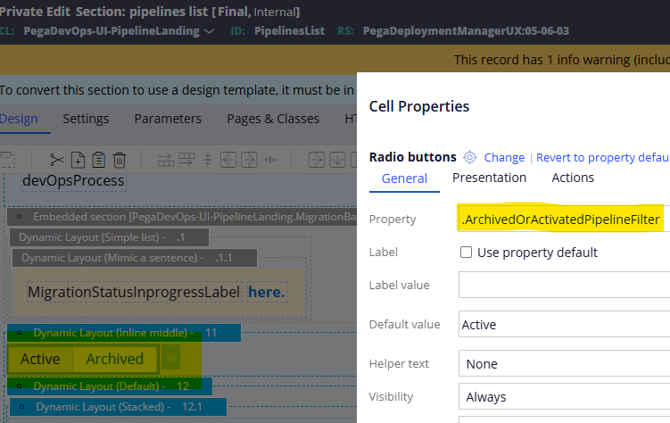

In practice, the number of archived pipelines can easily exceed 500.
When viewing the "Archived Pipelines" landing page, load times can exceed five minutes.
Testing has shown that editing the PipelinesList section (in PegaDevOps-UI-PipelineLanding) and adding pagination to the table (when "archived") significantly improves load times (see attached screenshot.)
However, as this is a final rule, the change cannot be made directly by clients.
This was noticed in Pega Deployment Manager 5.6.4.
Request
Could you please help optimize the landing page load times by enabling pagination for archived pipelines? Assistance in implementing this, or recommendations for alternative solutions, would be greatly appreciated.
