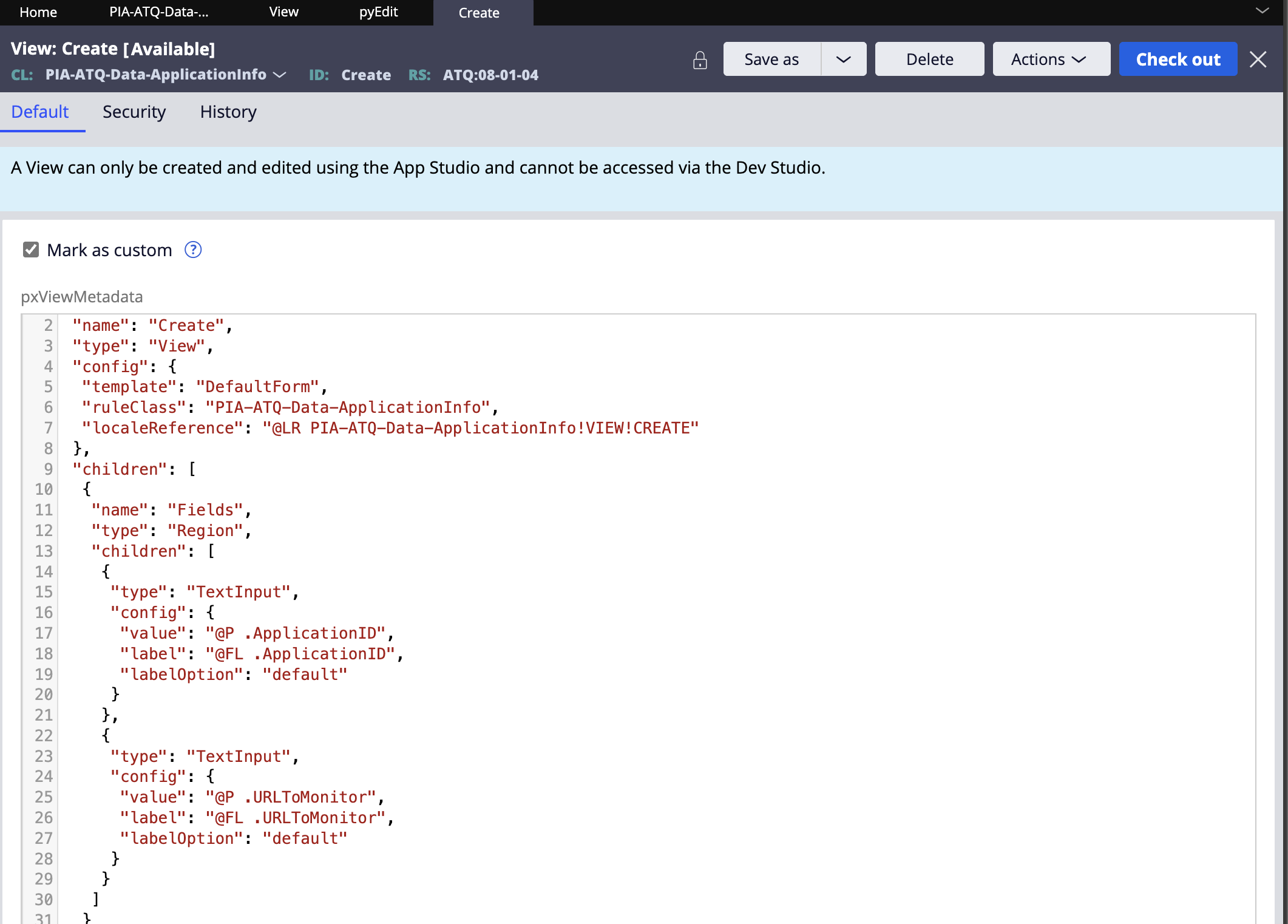

I realize this won't work without an Rule-UI-View - but I cannot create them without migrating my app or enabling hybrid mode. So I tried creating views (Create and pyEdit) from scratch, but to no avail.
