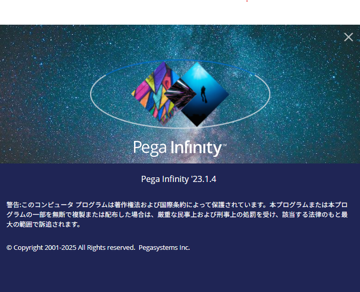

FPT Okinawa R&D Co., Ltd.
JP
I tried clicking on it, but it only shows the Pega version as in the image below, and I don’t see the System Information button. Do I need additional permissions in my access group to view it?
Note: I’m using an Author account.
NCS Pte. Ltd
SG
Hi @PhongH25: You need to have "pxViewSystemInfo" Privilege which is part of default SysAdm4 Role. If you have not updated the default Author access group, this should be available to you.
Thanks.
JP
I checked and it seems to be set up normally, but I still can't confirm. I think creating a SR ticket to confirm would be better.
