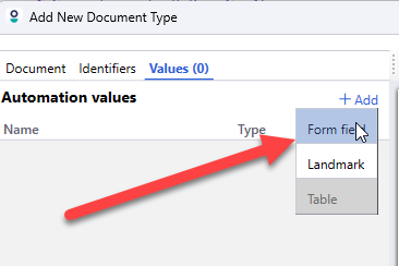

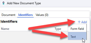

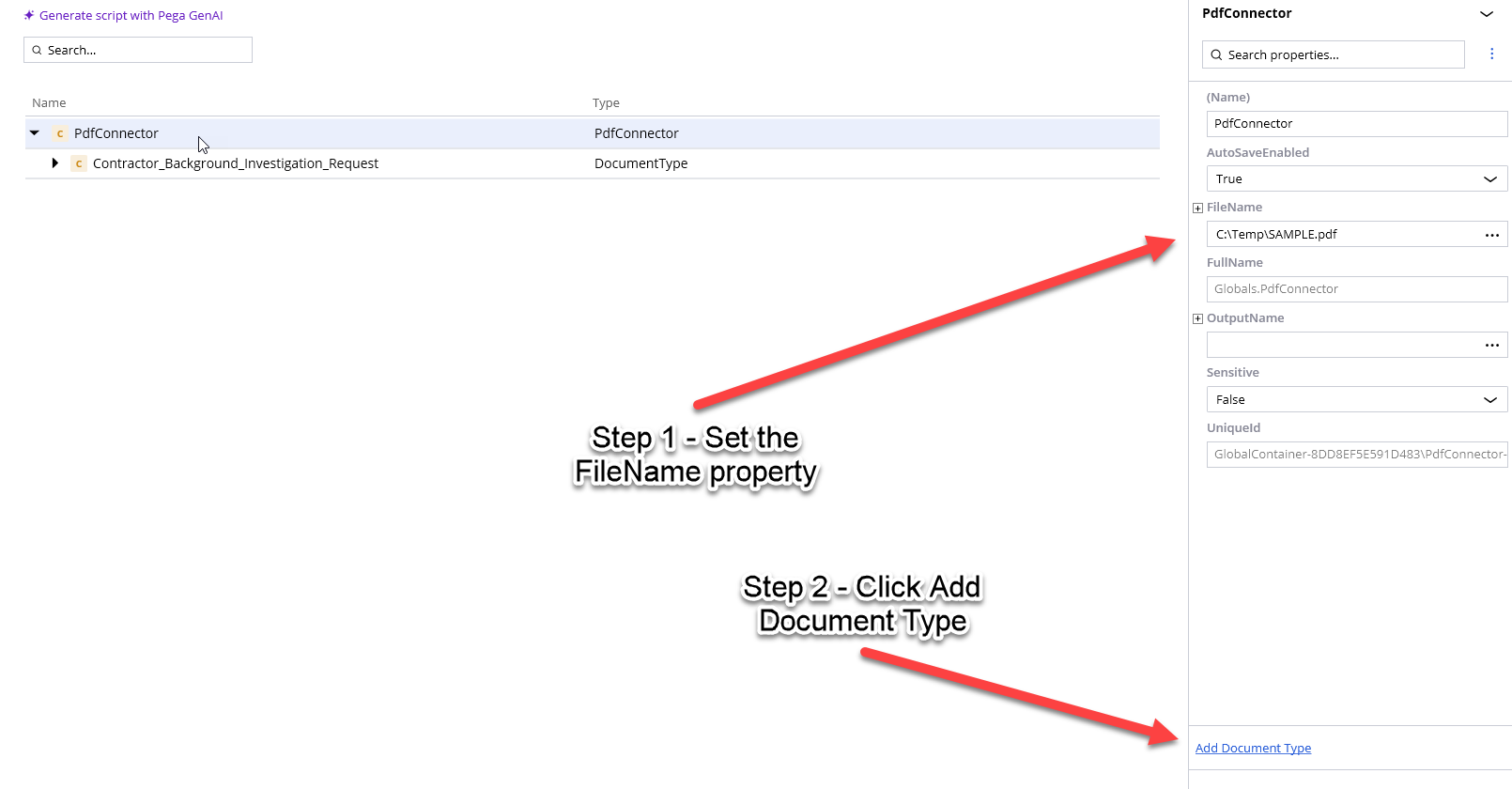

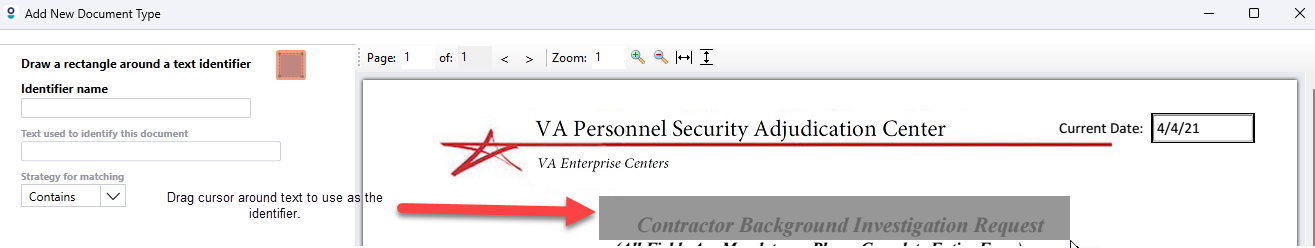

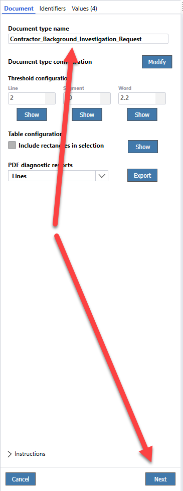

@JahriC17390650 Certainly. First, add a PDF Connector Component to your Globals. Next, you define a Document Type in the Connector. Here is where you can work with the PDF. It will automatically detect form fields but can work with them if you have OCR Essentials installed (which you should do anyway if you are working with PDFs). In the document type, you first identify the field, label, text, etc. that defines the document. How do you know it is this document type you are working with (in other words)? Once you have identified the document type, you may then add any form fields or any other areas you wish to read. These will show up as properties of the Connector once you save your changes. These properties are available within your automation to use as needed.

@JahriC17390650 Here is an example. I only defined the first four fields, but you can add the remaining ones from the connector if you wish (or whichever ones you need). I can attach screenshots too if that is helpful.

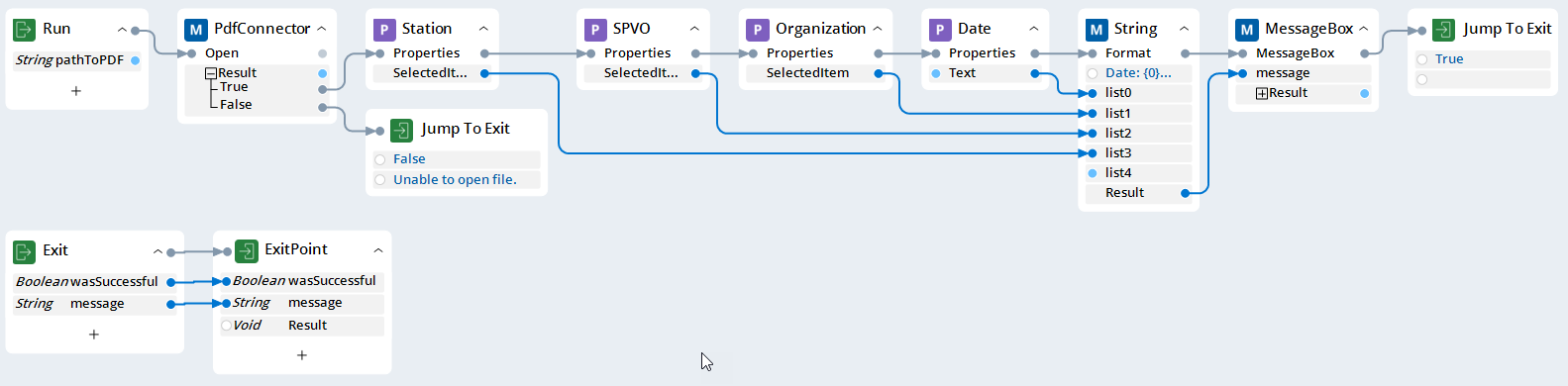

@JahriC17390650Here is an example with a UI to allow a user to select. I believe I will need to do another reply to attach screenshots. That will come momentarily.

@JahriC17390650 I believe all you need to do is call the close method when you are done with the file. When you need to read another, set the FileName property to the new file and call Open to connect to the new file.
