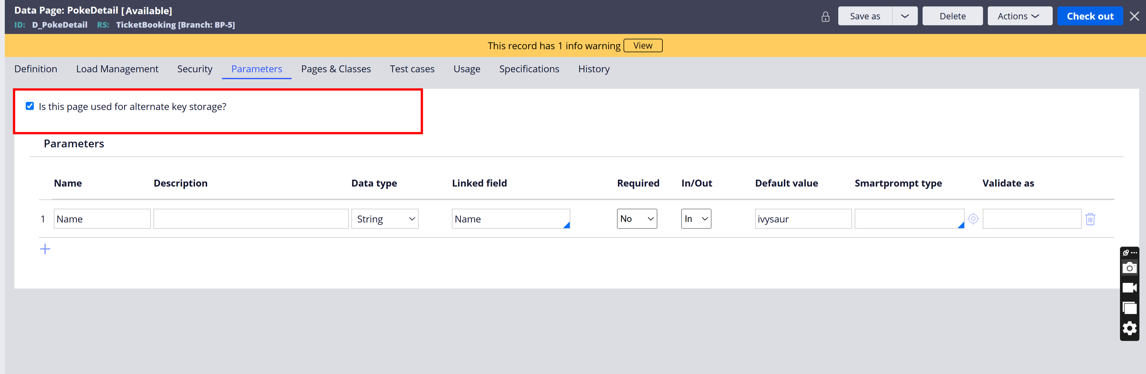

Since SoR is external, select “Is this page used for alternate key storage?” option and link Connector resource path parameters to respective properties.

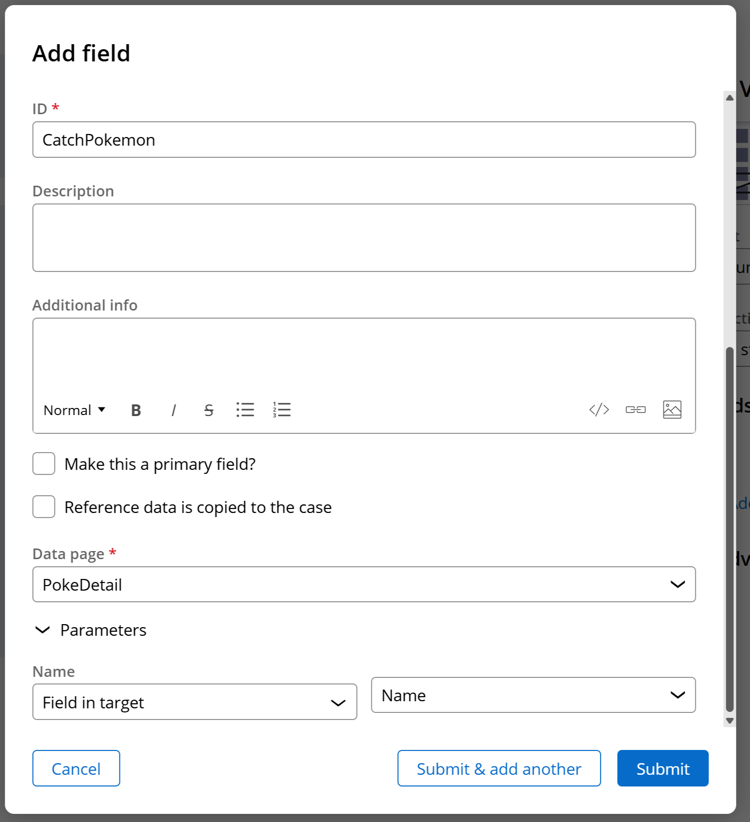

In the case workflow, the "Catch Pokemon" field was introduced to facilitate user interaction with the dropdown sourced from an external system of record. This field is designed to dynamically reference data, allowing users to select a Pokémon from a list and retrieve detailed information seamlessly.
In the screenshot below, you can note that when an item is selected from a list data page, the key (.CatchPokemon.name) is passed to the D_Pokemon data page.
This field is configured to select a Pokemon from a list and retrieve comprehensive details effortlessly. The screenshot below demonstrates its configuration in App Studio, showcasing how the selected item's key is linked to the corresponding data page, which is shown in the UI instantly thanks to Constellation’s capability to display details.
