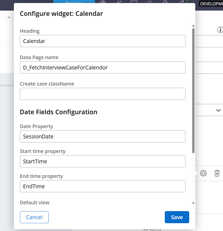

The Case type exposes a list Data page that provides all the instances of this case type. When configuring the widget, the name of the DP is passed to the component as parameter (D_AppointmentList) - Another parameter called 'Create case className' will show the 'create' button if this parameter is set.
Here is a screenshot of the widget configuration when adding it to a page:
