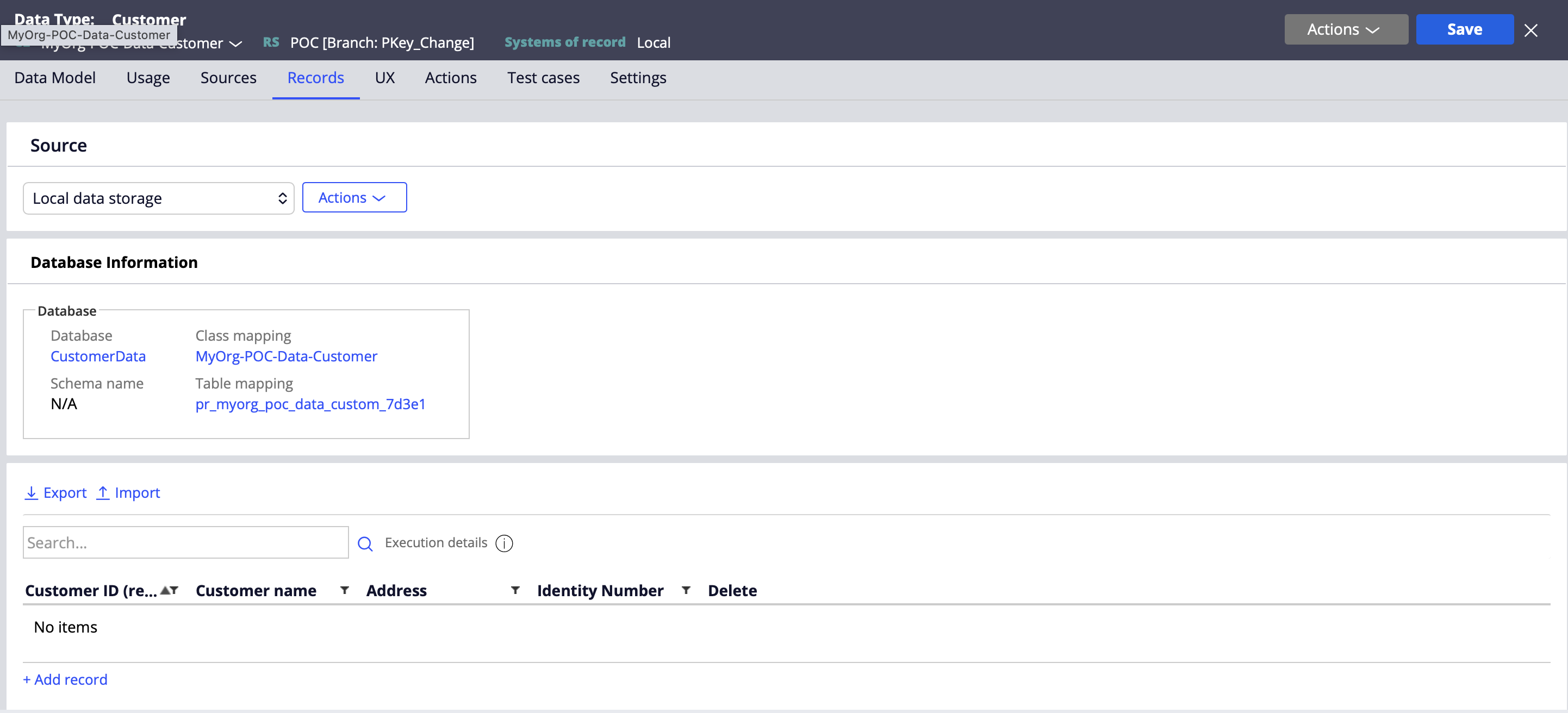

1) Export the table data (if records exist)
If the table already has data, export it first.

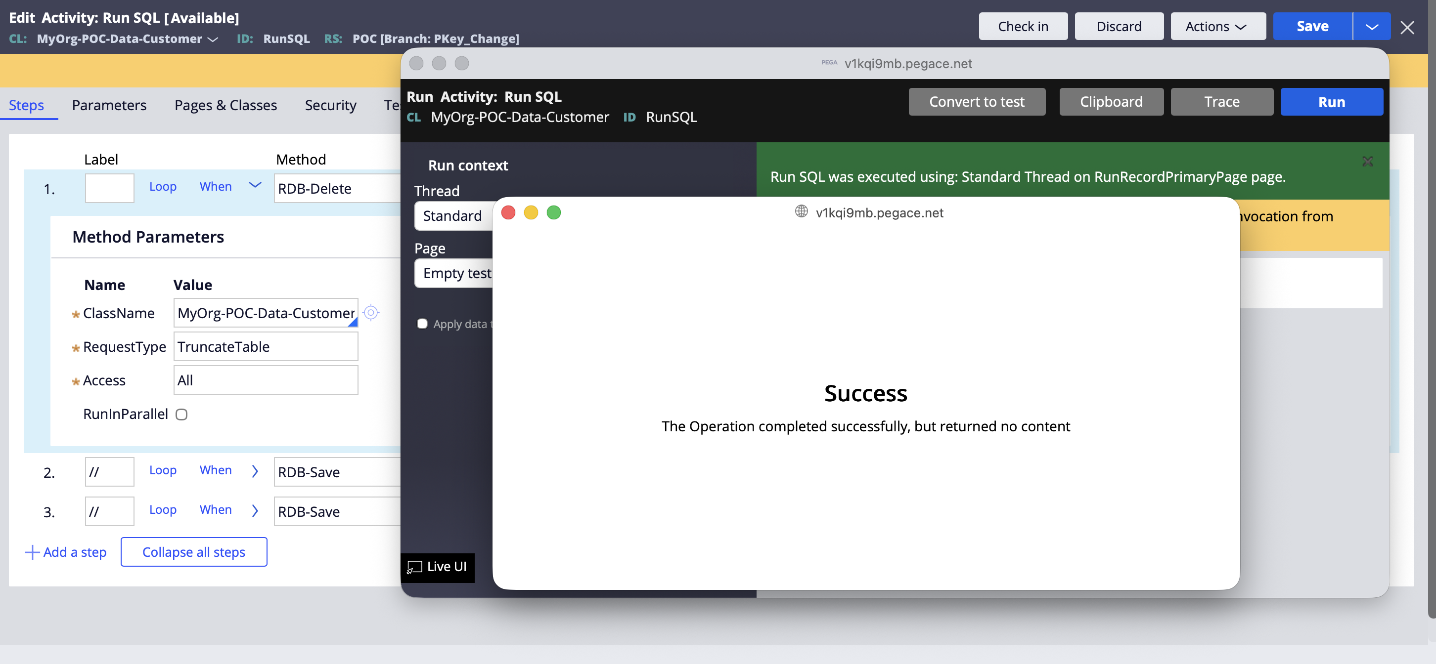

2) Truncate the table
Because you can’t drop a primary key cleanly while rows still exist (and because you want a clean re-import path), truncate the physical table.

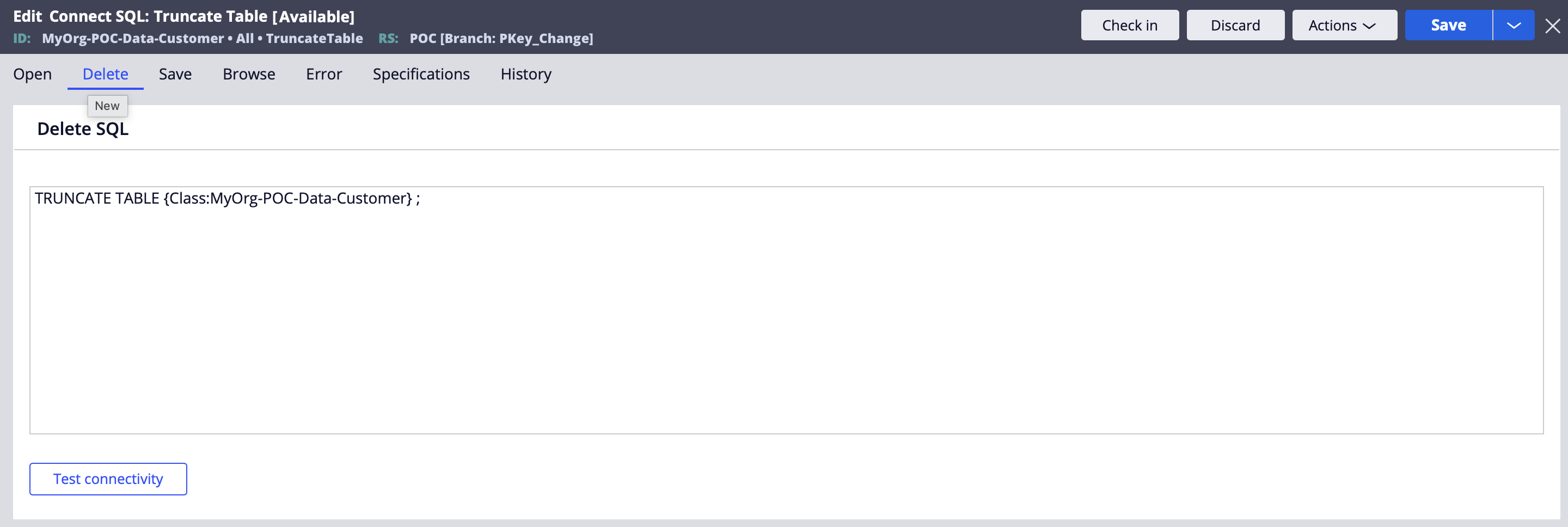

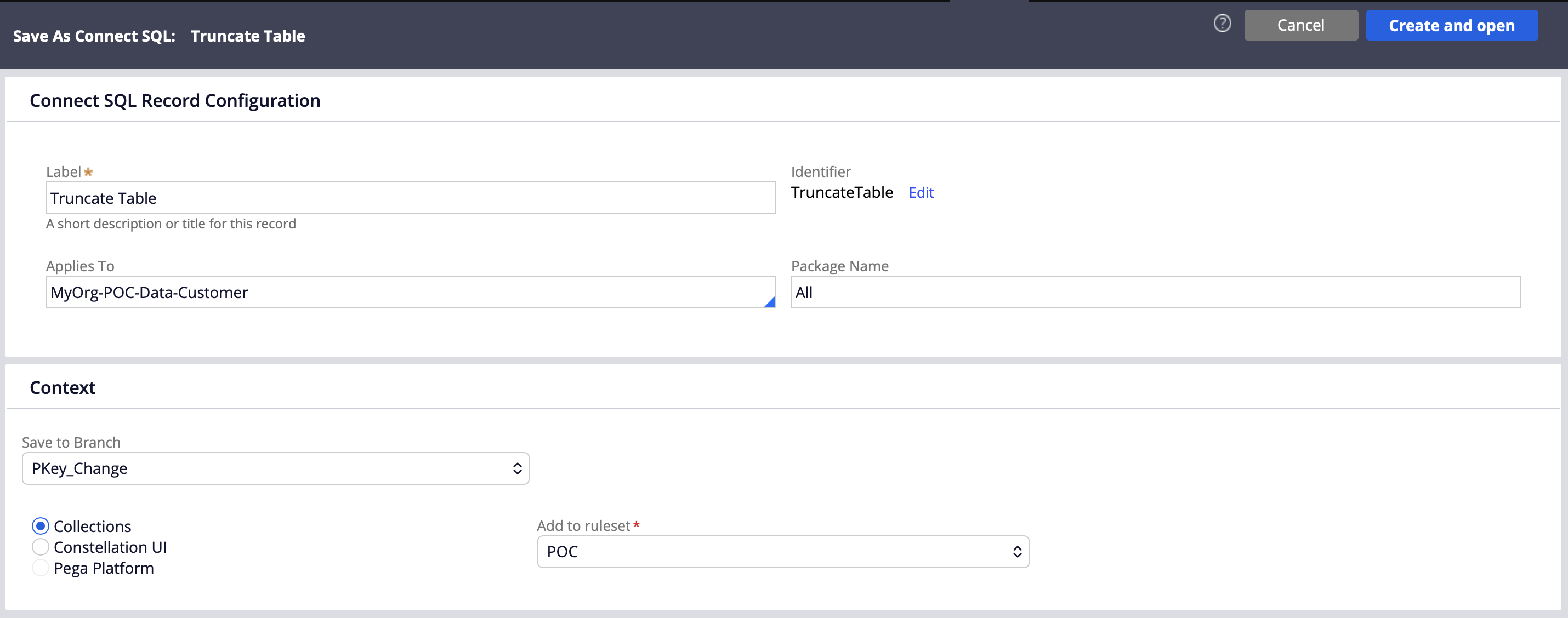

- Create a Connect SQL rule to write the SQL query to truncate the table.
TRUNCATE TABLE your_table_name ;
- Run activity to execute the Connect SQL

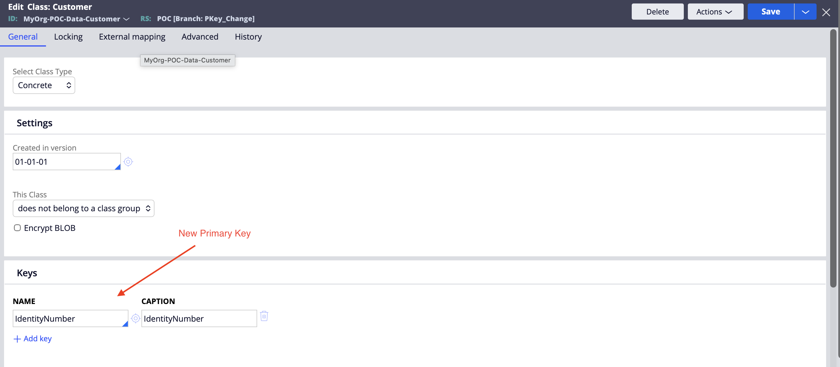

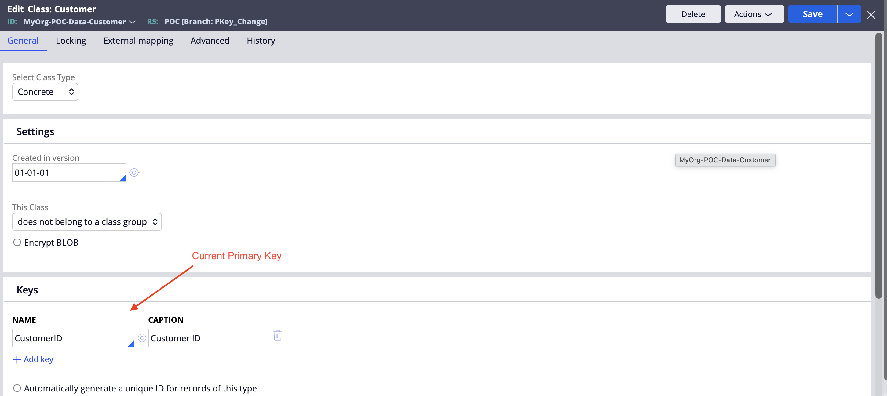

3) Change the key in the class and save the class rule
Update the Data Type / class rule metadata so Pega recognizes the new key:
Update the key property from
CustomerIDtoIdentityNumber
Save the rule
At this point, Pega’s metadata knows the new key, but the physical table still has the old PK constraint (until you change it).

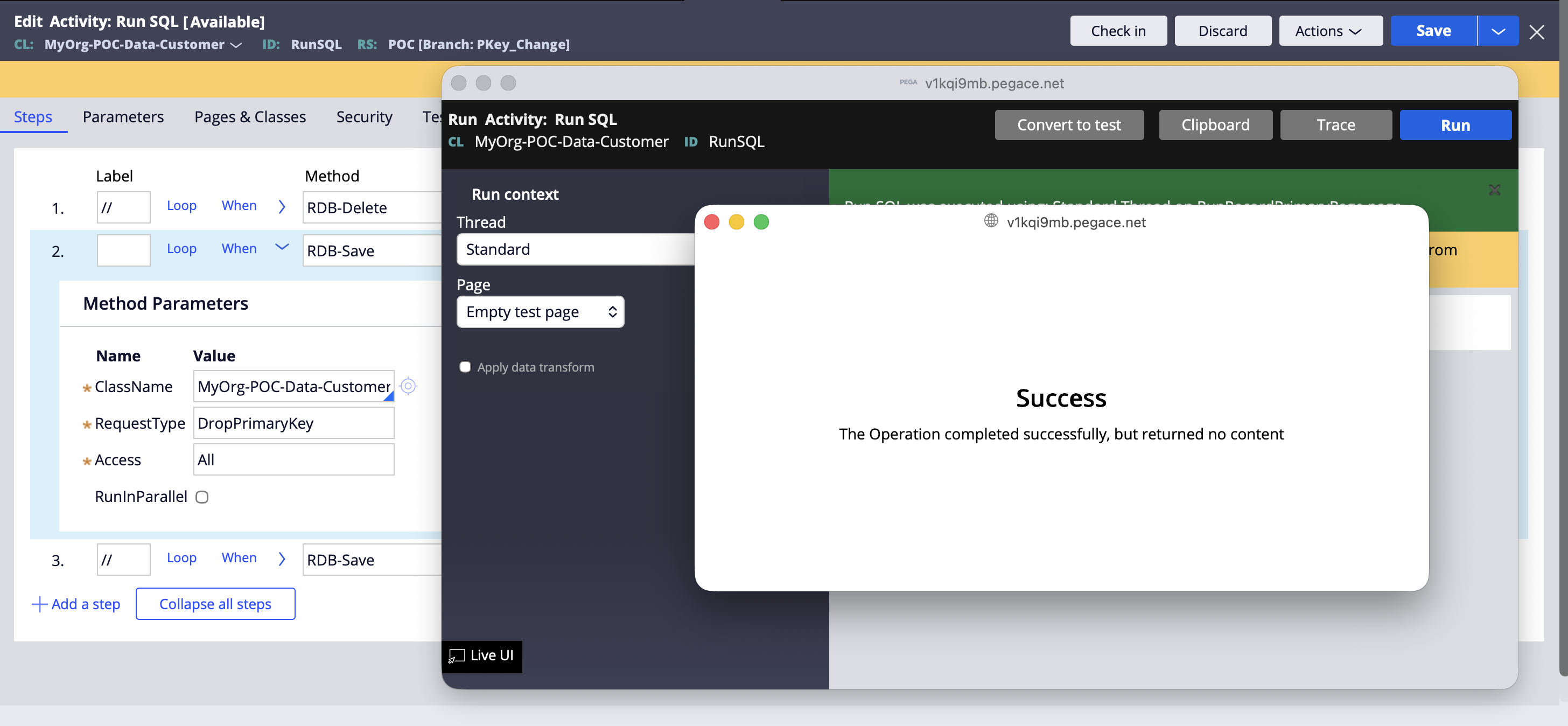

5) Create a Connect SQL to drop the existing PK constraint
Create a Connect SQL rule that drops the old PK constraint.
ALTER TABLE your_table_name
DROP CONSTRAINT your_constraints_name;
6) Run an activity to execute the Connect SQL

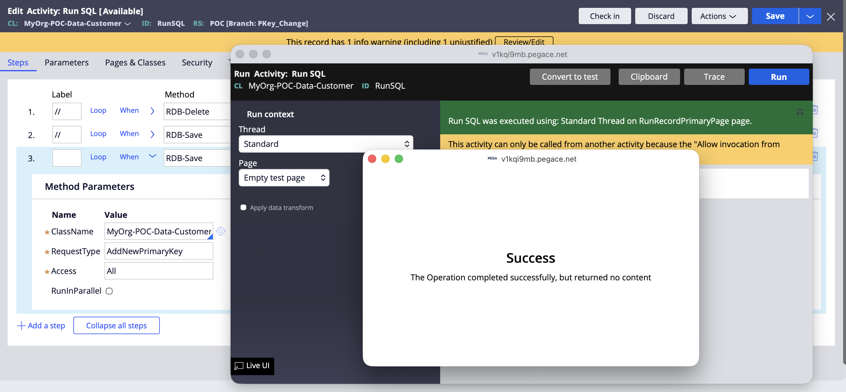

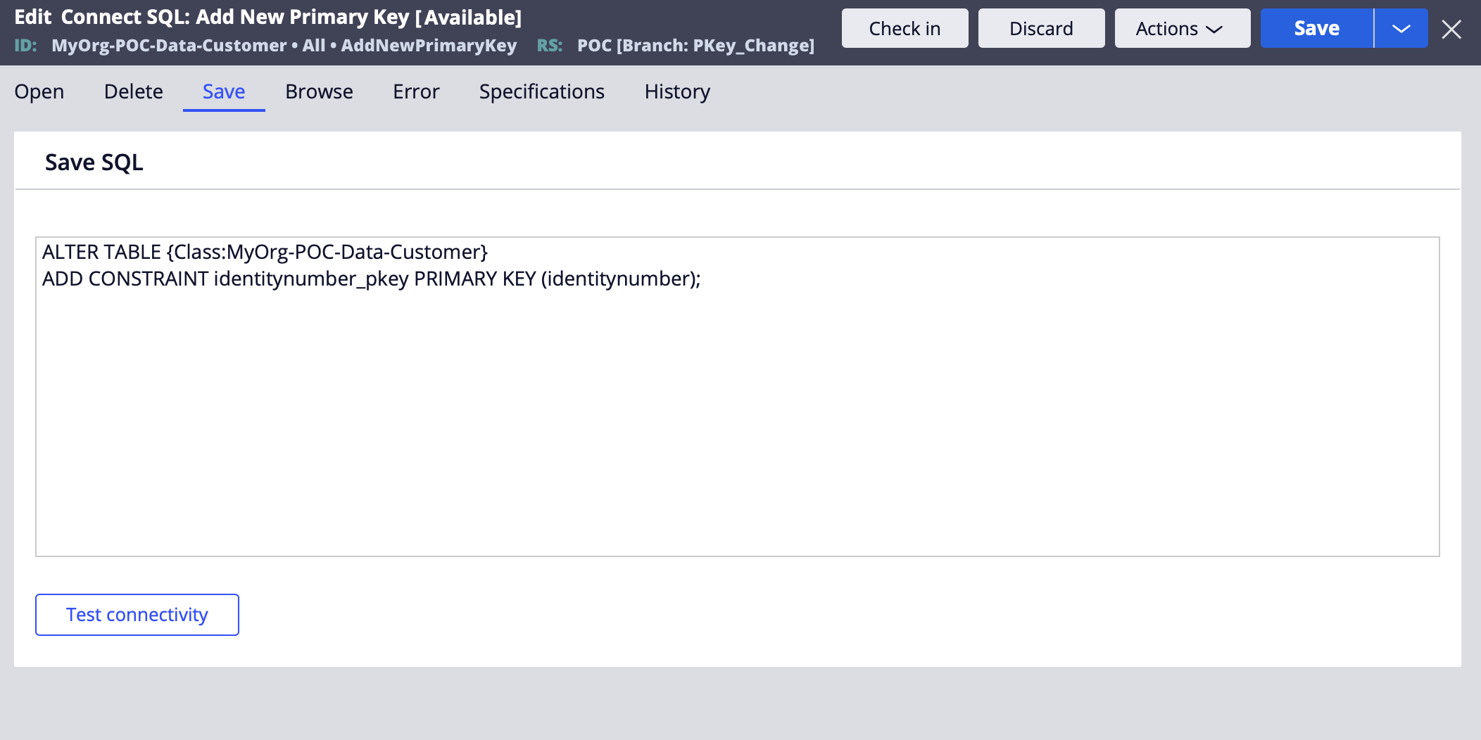

7) Add the new PK using another Connect SQL
Create a second Connect SQL rule to add the new primary key:
ADD CONSTRAINT constraints_name PRIMARY KEY (column_name);

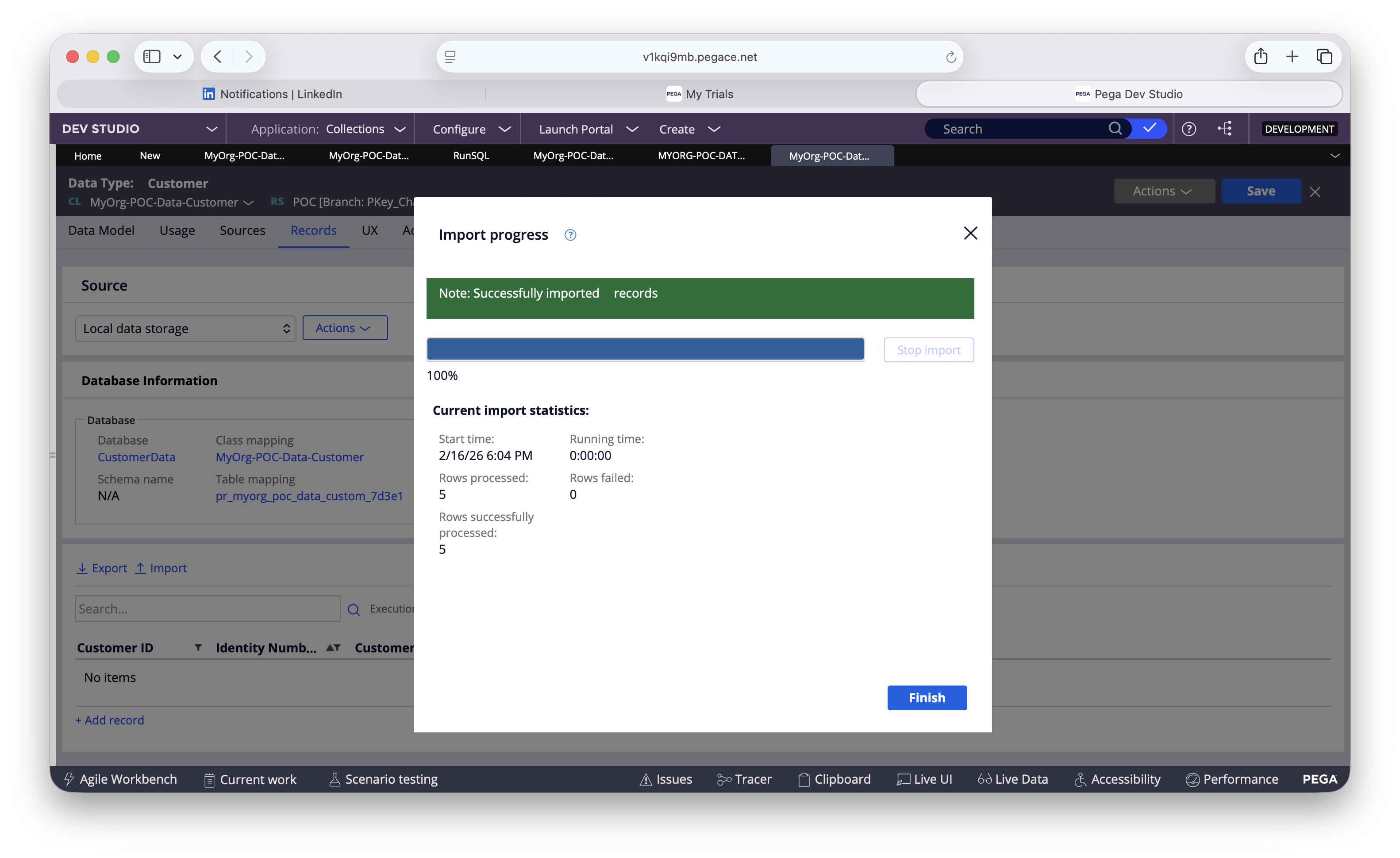

8) Import the records back
Finally, import the exported records into the table again.
After import:
validate row counts
validate uniqueness of
IdentityNumber
