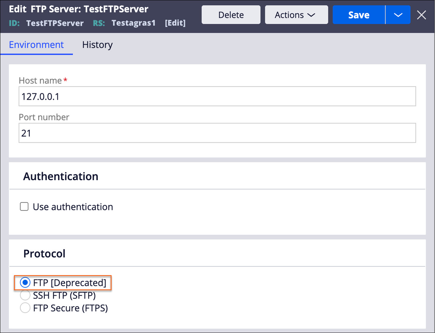

FTP server configuration is specified in ‘FTP Server’ rule. Perform the following steps to migrate to SFTP/FTPS:
- Setup a SFTP/FTPS server.
- Update the existing FTP Server rule with the new server details.
