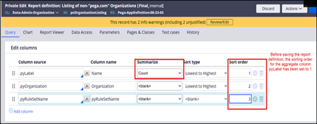

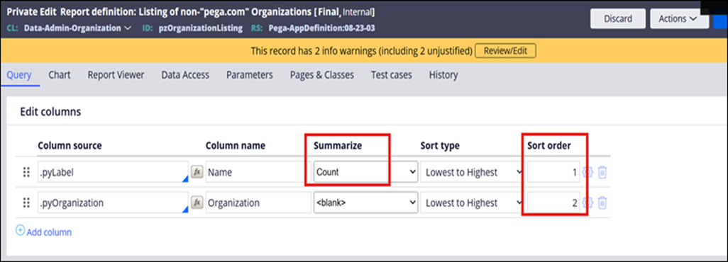

For example, when there are only two rows and the sort order for the .pyLabel Aggregate column is set to 1, the value of the sort order remains unchanged after saving the report definition. Refer to the following image:
However, the sort order should have been 2 for the .pyLabel aggregate column.

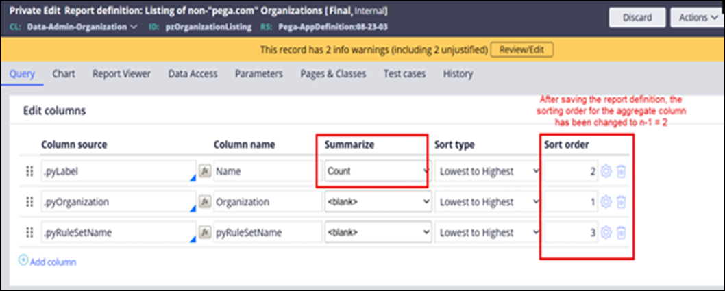

When there are more than 2 rows and the sort order is set to 1 for the ‘.pyLabel’ aggregate column, after saving the report definition, the value of the sort order for the aggregate column is changed to n-1 (that is, when n = 3; n-1 is 3-1 = 2). Refer to the following image:
The sort order should have been set to 3 for the .pyLabel aggregate column. Refer to the following image:
