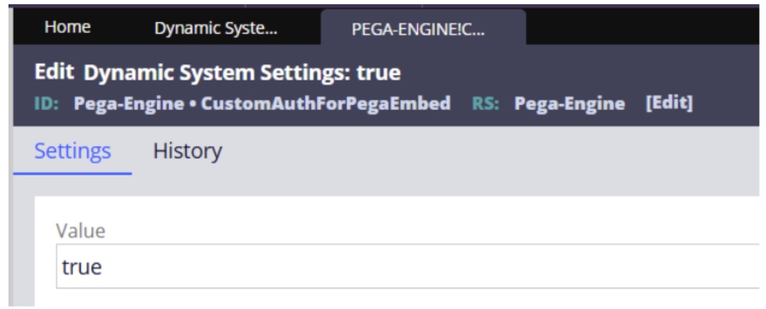

Enable customBearer custom authentication method
1. In > > , create new setting as follows:
Setting purpose: CustomAuthForPegaEmbed
Setting value: true
Owning ruleset: Pega-Engine

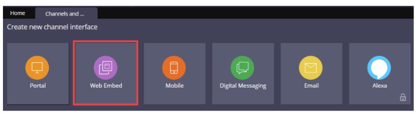

Create web embed
2. In create new
3. Select “Custom bearer” auth method type.
4. Generate web embed code.

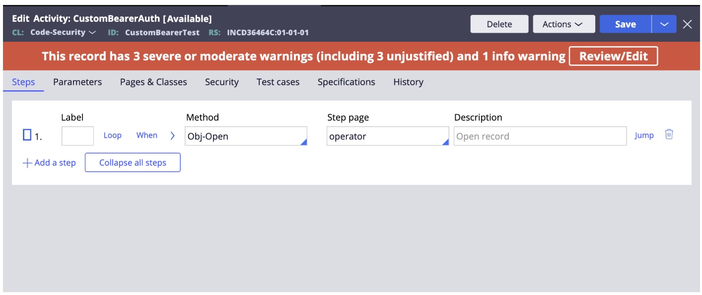

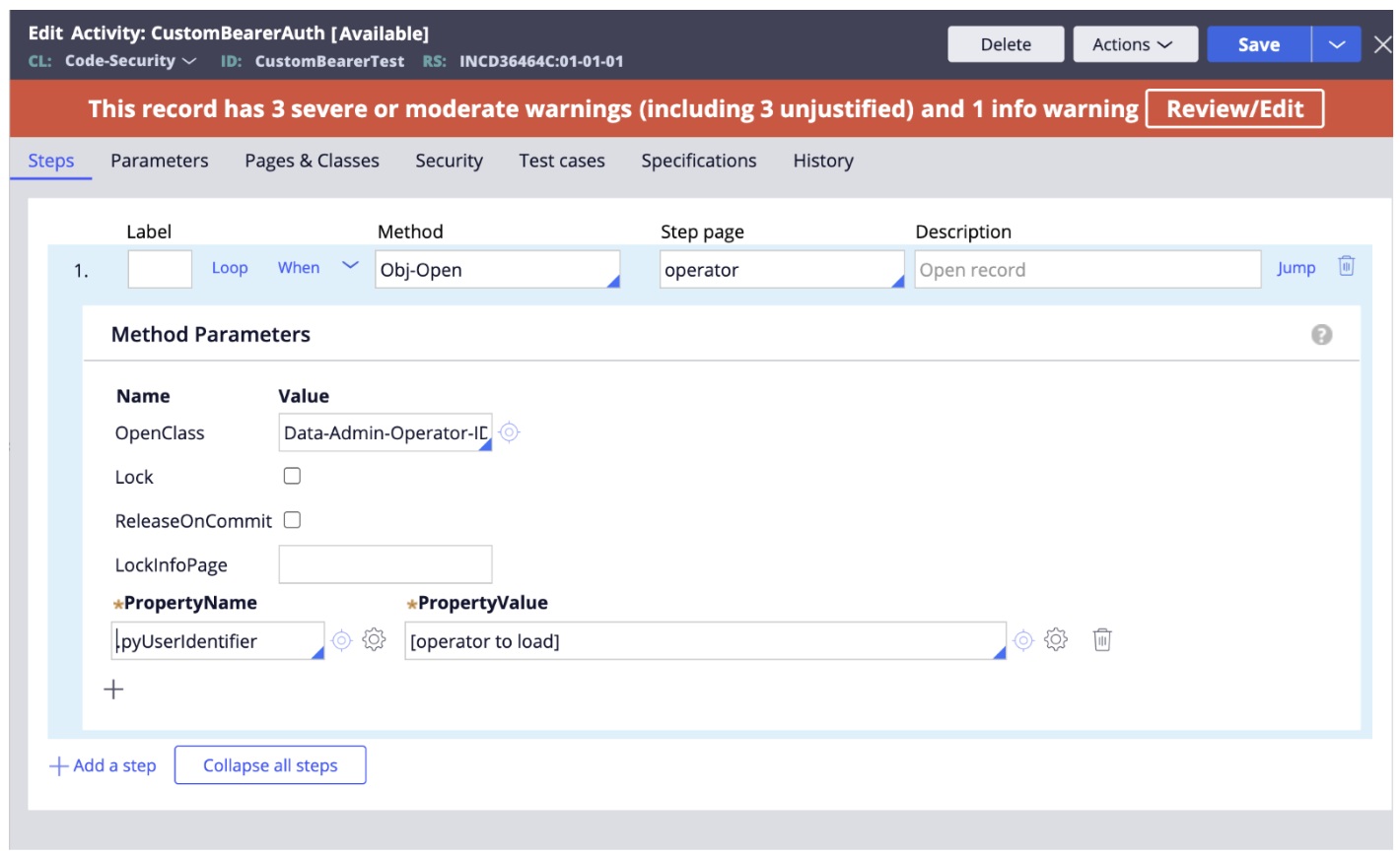

10. Create new activity, for example “GuestUserAuth”.

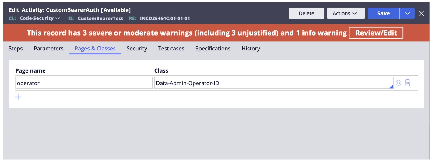

- Add page to Pages & Classes tab:
- Page name: operator
- Page class: Data-Admin-Operator-ID
- Add step 1:
- Step page: operator
- Method: Obj-Open
- OpenClass: Data-Admin-Operator-ID
- PropertyName: .pyUserIdentifier
- PropertyValue: <OperatorID>

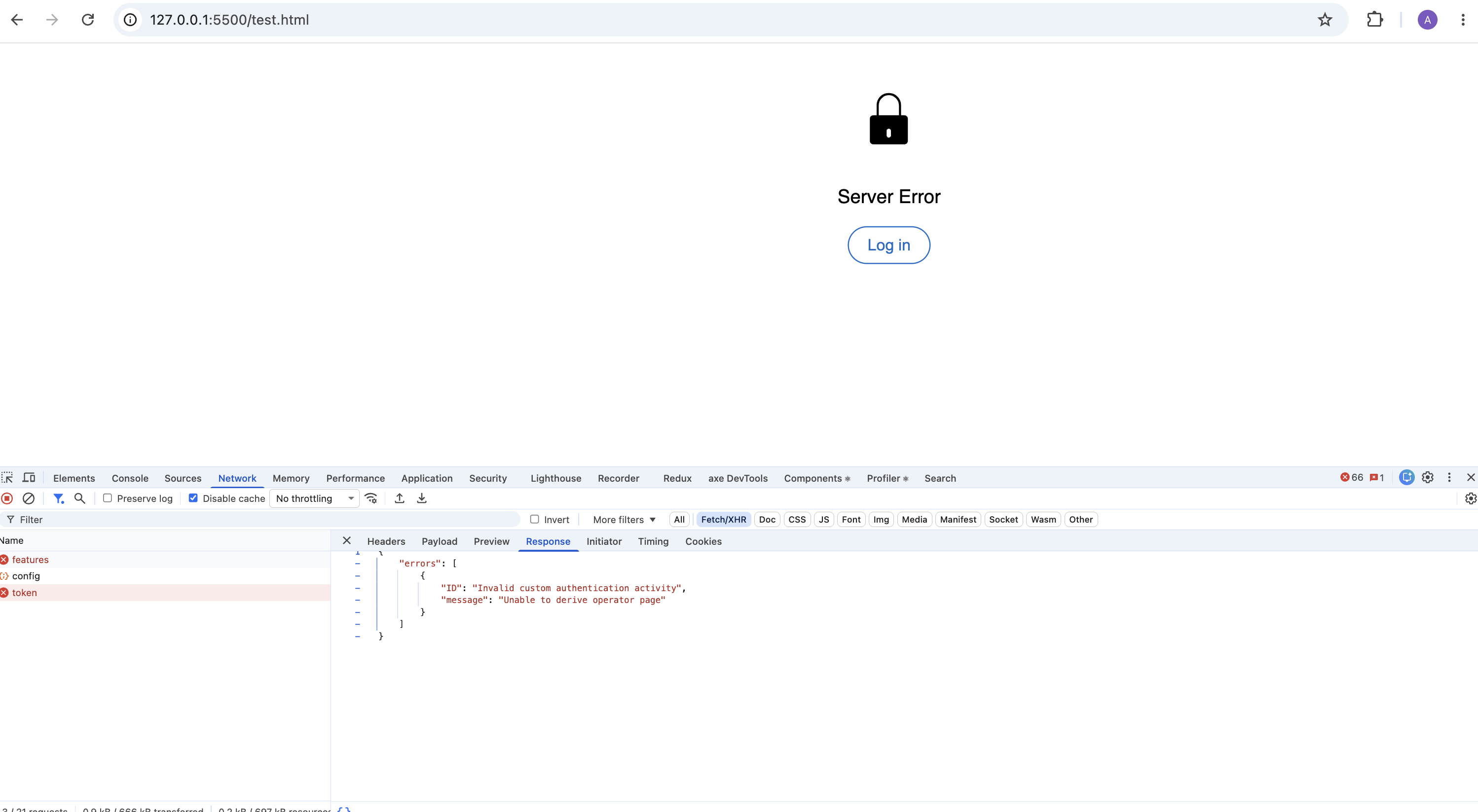

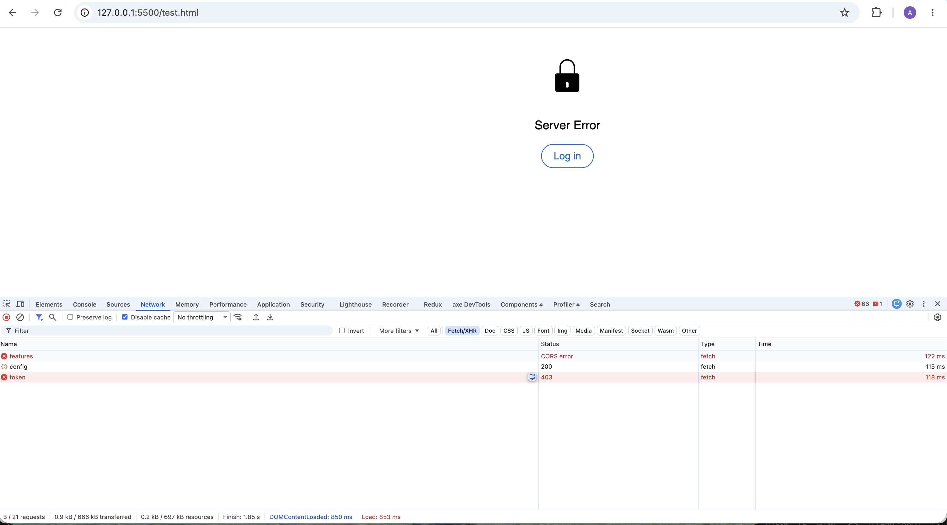

Symptom
Error
"errors": [
"ID": "Invalid custom authentication activity",
"message": "Unable to derive operator page"

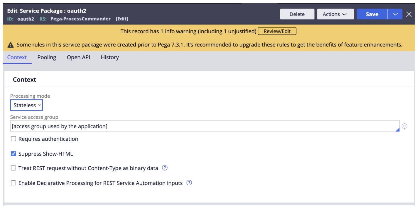

The OAuth 2.0 Service Package Access Group must reference the same application context expected by the custom authentication implementation. If an incorrect or outdated Access Group is configured, Pega Platform may be unable to establish the authenticated operator context, resulting in the error "Unable to derive operator page" during token generation. The internal resolution includes updating the OAuth2 Service Package to use the correct application Access Group.

The solution involves updating the OAuth 2.0 Service Package access group to reference the correct application access group for your Web Mashup configuration.

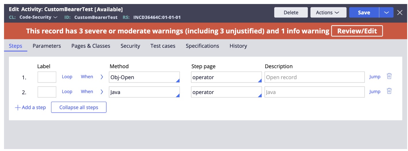

Update the custom bearer activity:
1. Open the custom bearer activity from Client OAuth 2.0 registration rule.
If there is no activity, create a new activity, as this is a required field.
2. On the Page & Classes tab
1.Add an “operator” Page from Data-Admin-Operator-ID class.
2. Add a step to load the operator. In this step, call Obj-Open to load the operator record
Ensure that pyUserIdentifier is set appropriately for the operator record you want to load.

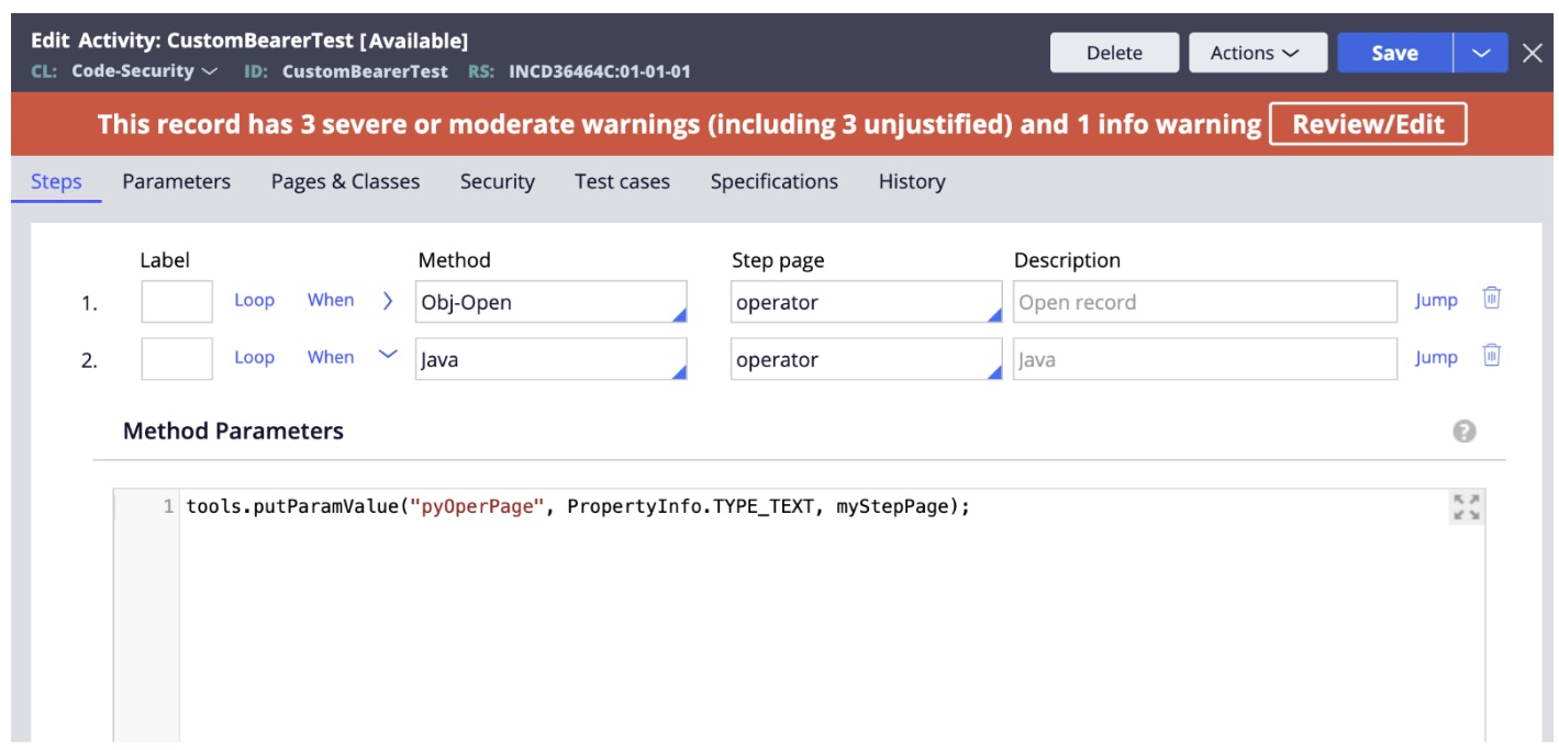

3. In the Steps tab, add one more step (Step 2).
- For this step, set the Method to Java.
- Configure this step to execute the following Java code:
tools.putParamValue("pyOperPage", PropertyInfo.TYPE_TEXT, myStepPage);
4. In both steps, make sure the Step Page is set to the "operator" page. Otherwise, the process will still return an error.
Update the OAuth 2.0 Service Package so that the Service Access Group references the access group used by the application:
5. Go to >

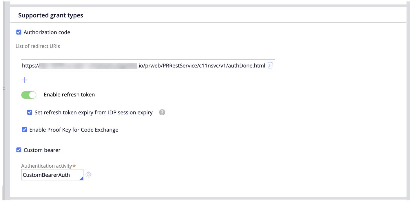

6. Open the record corresponding to the web embed created in previous steps:
- Enable Custom bearer flag
- Set the authentication activity
7. Modify the oauth2 service package.
