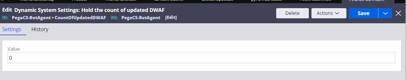

- Make sure CountOfUpdatedDWAF DSS value is 0. Once the utility is started this DSS holds count of records for which records are cleaned.

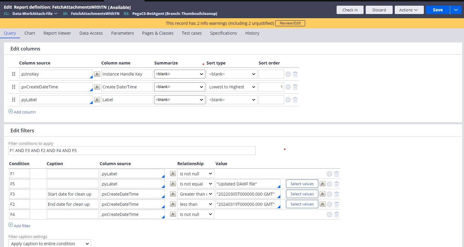

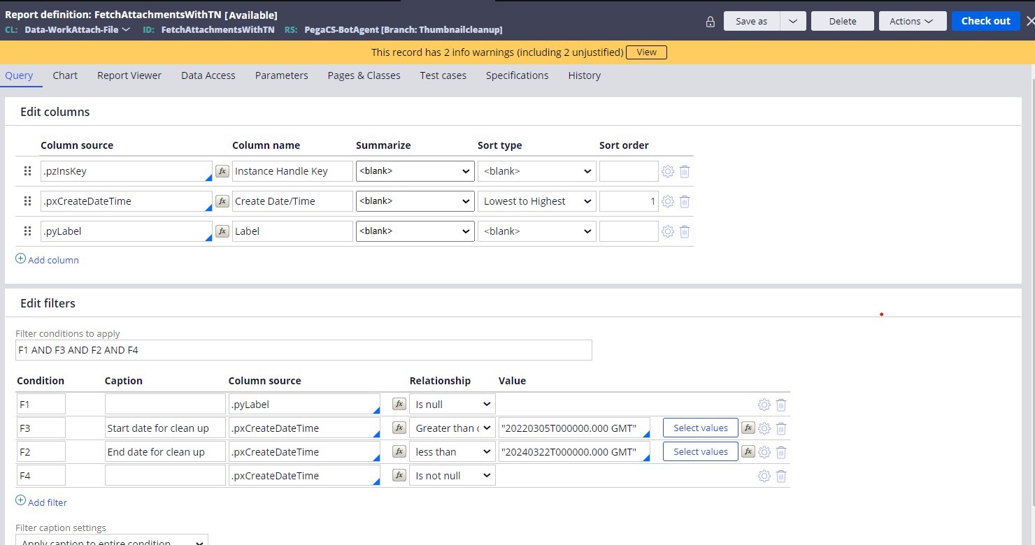

- Update the start date and end date in FetchAttachmentsWithTN RD. Start end is the date when czThumbnail is introduced which is on April 5th, 2022 or you can update the start date from April 5th to date when your system is above 8.7.1 version. End date is the date when the Hotfix/Local change to remove the logic to store czThumbnail in DB is introduced in production system.

- Before starting the utility, please run CleanedUpDWAF RD and check if the records with pyLabel is empty in the system. If the system has any records in the given date range. Please update RD as below and run the JS till the above records are cleaned. This has to be done in start or end of the utility.

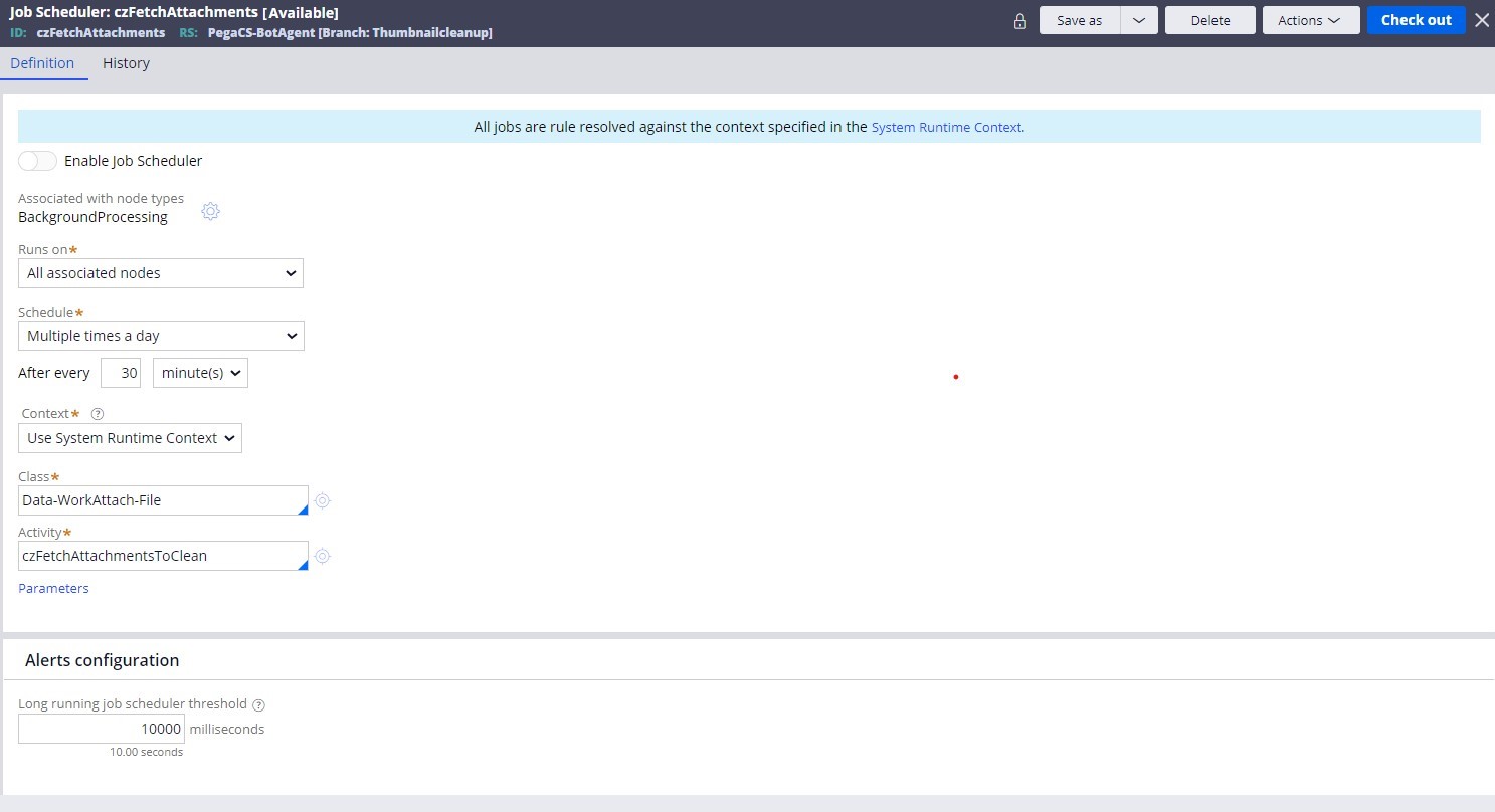

- Enable czFetchAttachmentsJob scheduler. Currently it runs for every 30 mins which pushes 500 records on each run. Please adjust the time in your system as per the size and time it takes in respective system by observing few runs. Also for now it pushes 500 records you can reduce the number if the system is slow.
