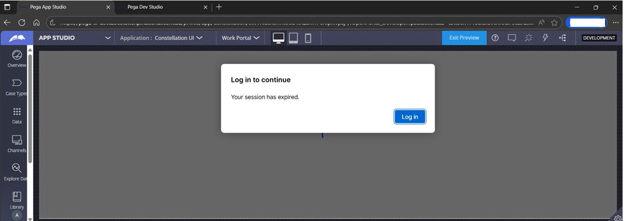

Users experience unexpected logouts from the Service Desktop during active calls.
After AG timeout period has passed, active users who navigate back to the portal are logged out and are presented with the login screen.
Steps to reproduce
Configure AG timeout in a Constellation‑based application on the affected versions.
Log in and continue normal work through Constellation (stateless DX API calls).
After the configured AG timeout is triggered, the session terminates abruptly, despite continued user activity.
