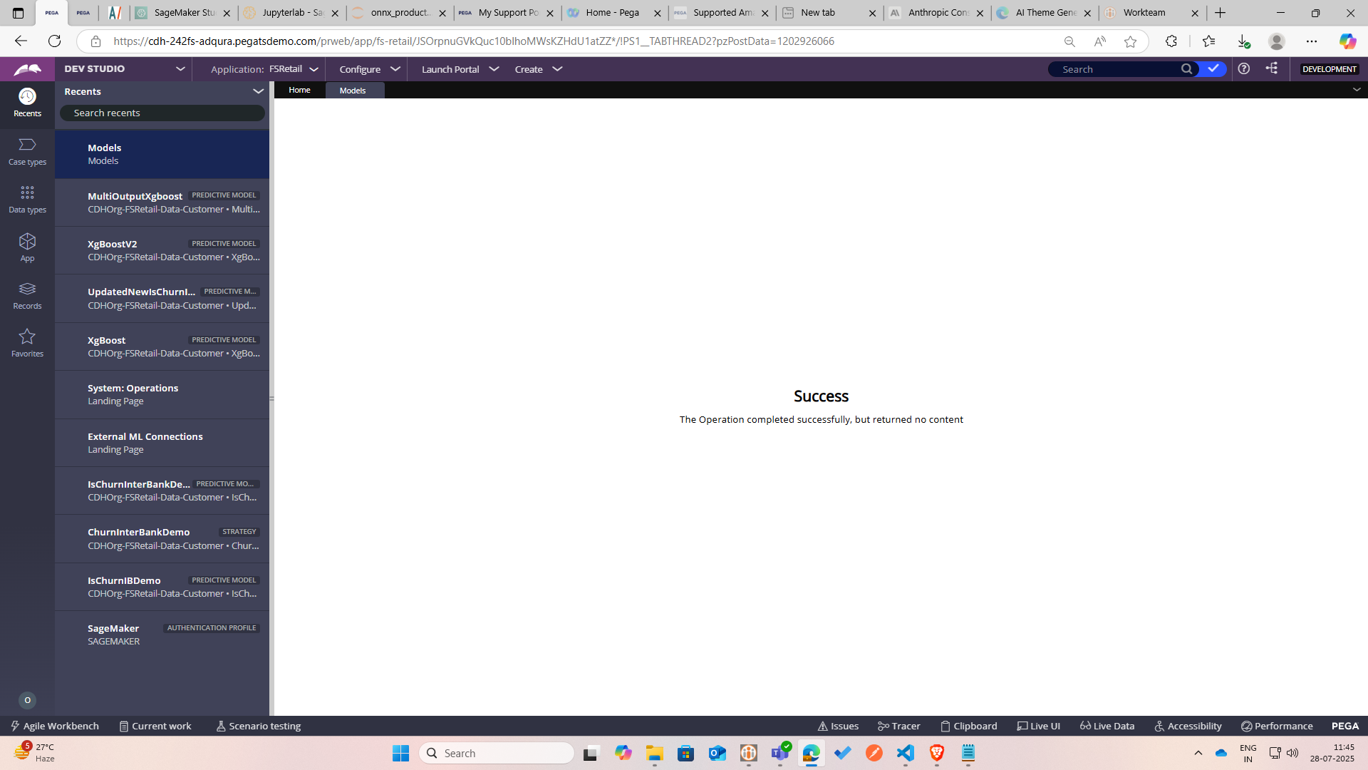

Issue Summary: I am experiencing multiple issues when attempting to import an ONNX model trained on AWS into Pega Prediction Studio. The model import process shows "Success" but returns no content, followed by various errors in the system logs.
Detailed Description:

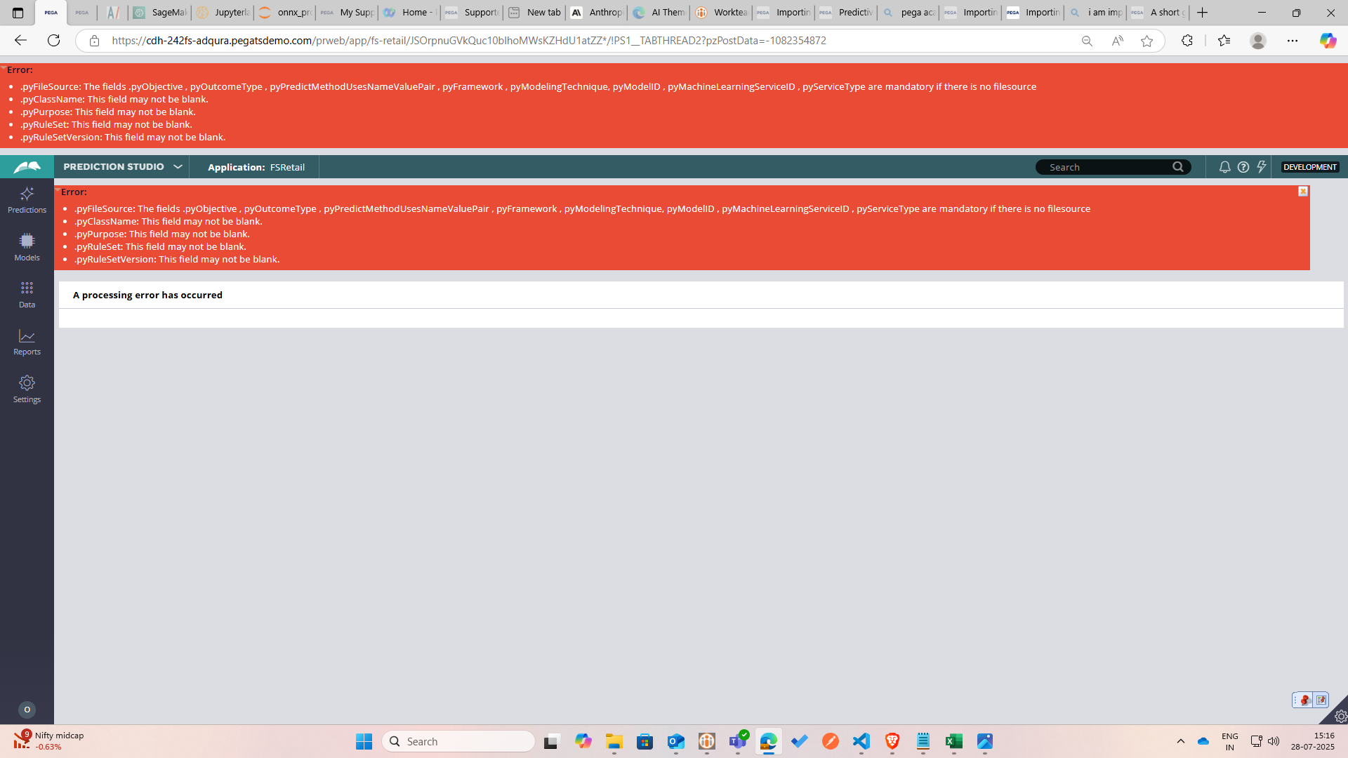

I trained a loan default prediction model using scikit-learn on AWS and exported it to ONNX format. When importing through Prediction Studio > Models > Import, the system displays a success message but returns no content, and I encounter the following issues:

2. Rule Creation Errors:
com.pega.pegarules.pub.database.BadClassDefinitionException: Attempting to access a rule with a bad defined-on class: Trying to open rule "" of class "Rule-Decision-PredictiveModel", but no defined-on class (pyClassName) was specified.
3. Model Configuration Errors: The system indicates the following mandatory fields are missing:
- pyFileSource
- pyClassName
- pyObjective
- pyOutcomeType
- pyPredictMethodUsesNameValuePair
- pyFramework
- pyModelingTechnique
- pyModelID
- pyMachineLearningServiceID
- pyServiceType
- pyPurpose
- pyRuleSet
- pyRuleSetVersion

- Screenshots of the import process and error messages
@Shaik Kabeer
Your issue is mainly due to two things: the ONNX Runtime version bundled with Pega needs GLIBC 2.27, but your OS likely has an older version (like 2.17), so it fails during model load. To fix this, try downgrading to an older ONNX Runtime version (like 1.10) that's compatible with your OS, or consider using an external ML service instead. Also, the ONNX file you imported is missing required metadata like pyClassName, pyOutcomeType, etc., which Pega needs to create the prediction rule. When converting your model to ONNX using Python, make sure you include these metadata fields using metadata_props. Without them, Pega can’t complete the import, even if it says “Success.” Finally, if metadata can’t be added easily, manually create the model rule in Prediction Studio first, then upload the ONNX file to that rule
