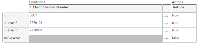

Here is a screenshot of the When Rule, this rule uses the PEGA internal function "ObtainValue" (no longer usable with 7.1.9 expression builder) and looks to a Decision Table called "DetermineSIMCardKitStatus", if the table returns "True" then the When Rule evaluates to "True":
The Decision Table that is called returns a "True" or "False" value based off of a client parameter:
I am aware that in an activity we could just set a property based off of the decision table, but we also use these types of When rules in our UI visibility rules as well. I am trying to figure out a new design approach to this type of scenario that stays within the guardrails (minimal customization) as much as possible. The old PEGA internal functions are still able to be used, if you pull up the records you can find them there but its not very effective especially when your not sure of which function you are looking for and the syntax for it.
