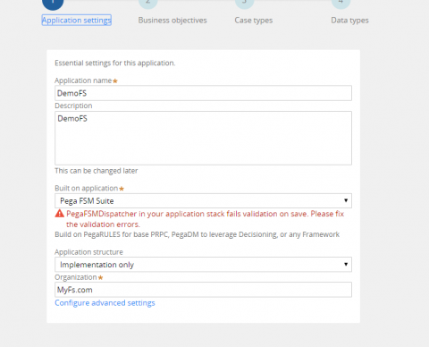

Hi ,
i am tryoing to create new Application in Pega Field Service.in Built on Application i am selected PEGA FSM Suite.
when Click on Save i am getting this error .
PegaFSMDispatcher in your application stack fails validation on save. Please fix the validation errors.
please help me on this.and how to create new Application with pega field Service.

Hi ,
Thanks for reply.
i am getting this below error while Click on Next..
i filled every thing in Advanced Configuration and application Settings.when i select Pega FSM Suite or releted to pega Field Service in Built on Application i am getting this error and same thing when i slect Pega rules in Built On Application i am not getting above error..
i am trying to Create One New demo Application for Pega Field service.

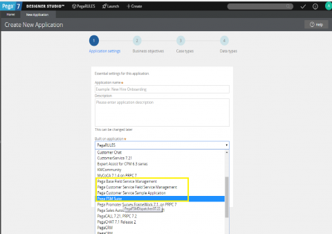

in PDN pega field Service Implementation Guide,
like this it is..but i didnt see any field service option in Built on Apllication.
Hi ,
Thanks for reply.
please let me know which option i have to select in Built On Application.
i am new to pega Filed Service.

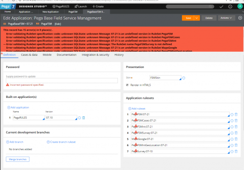

Could you please let me know how to sort out the below issue w.r.t Application stack ? in Pega Field Service.
while opening the Application stack ruleset, i am geting below errors.
when click on Save.
when click on Save.
Error validating RuleSet specification: code: unknown SQLState: unknown Message: 07-21 is an undefined version in RuleSet PegaFSMCases
Error validating RuleSet specification: code: unknown SQLState: unknown Message: 07-21 is an undefined version in RuleSet PegaFSMInt
Error validating RuleSet specification: code: unknown SQLState: unknown Message: The RuleSet name PegaFSMSurvey is not defined
Error validating RuleSet specification: code: unknown SQLState: unknown Message: 07-21 is an undefined version in RuleSet MapsGoogle
Error validating RuleSet specification: code: unknown SQLState: unknown Message: 07-21 is an undefined version in RuleSet PegaFSMIntGeoLocation
Error validating RuleSet specification: code: unknown SQLState: unknown Message: The RuleSet name PegaSurvey is not defined
The version of this RuleSet specification must include major and minor version parts.

Thanks for the screenshots.
If you open the PegaBaseFSM application and there you can see PegaFSMSurvey:07-21,PegaSurvey:07-10 rulesets.
Can you try opening them from the rule opener icon next to them?
1)If you are not able to open PegaSurvey:07-10 ruleset you have not properly imported survey ruleset.
2) in my above reply total Records 5810
Total Records moved 55
that means Rule import is not properly done.which is causing the issue.
My guess is you have not imported Pega Survey ruleset before importing Field service applicaiton jar.And while importing field service jar you might have got import issues which skipped so many rules(only 55 were moved out of 5810) which is causing the issue.
