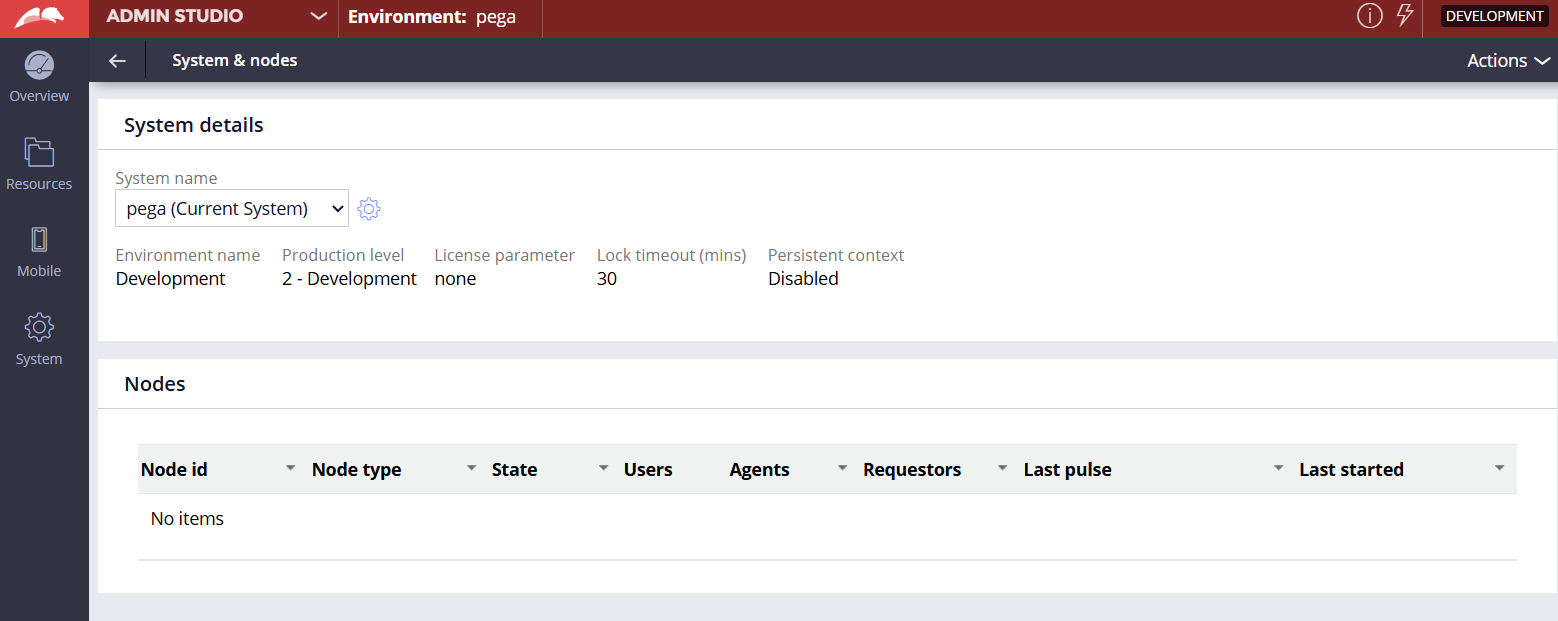

Up to Pega 24.2, for PoC purposes, I was able to create a single Docker container (NODE_TYPE=WebUser,BackgroundProcessing,Search) Pega node while externalizing Kafka and SRS. I used the same "recipe" for Pega 25, the node came up successfully. I am able to log in, navigate Dev / App studios etc. However, there's one issue.
When I used Admin Studio to list the nodes, I got ZERO nodes running. Admin studio did not list the node that I have logged into.
In the PegaRULE.log file, I saw this:

Upon more investigation, I have isolated the line of Java code that gives the exception is as follows:
Map<String, String> clusterInfo = pega.getSystemOperationsProvider().getClusterManagementAPI().getClusterInformation();
It's my understanding that Pega 25 no longer makes use of Hazelcast. My question is, what additional environment variables are required to pass in a Pega 25+ container in order to resolve the problem that I outlined above?
