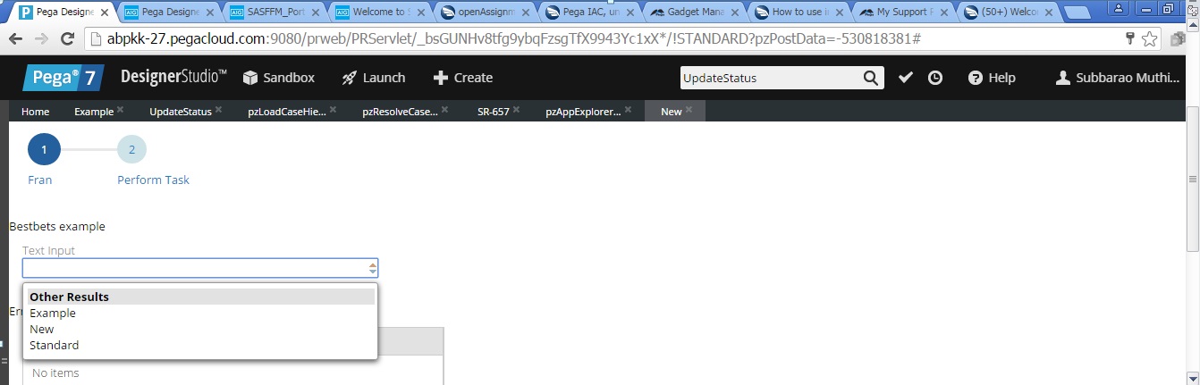

Thanks for the response Sanatanu,
I did the same, but i could not see any difference in results except Other Results header (see below attachment).
Here i have analysed the Autocomplete control used in App Explorer which is storing the class names into pyDeveloper page as best bet in statndard Thread when i select classes in App explorer.
Please let me know the document or link where i can find the implementation details for Pega 7 Autocomplete control. Thanks in advance.
