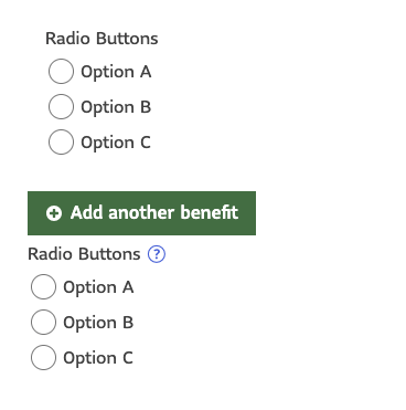

I am trying to figure out why the helper icon for controls do not render properly inside a table.
I have a radio button with "Helper text" set to "Help icon with overlay on hover". When this control is outside of a table, the help icon and hover functionality works normally. But when the control is inside of a table cell (data source for the table is a Page List), no icon appears. This is a non-optimized table.
Is this a known limitation/defect?
Screenshot below shows two radio buttons, both configured the same - one in a table cell the other outside. This behaviour is the same for any type of control that has the "helper text" option. Inspecting the generated HTML shows that the <i> for the helper icon is not present for controls inside a table.
