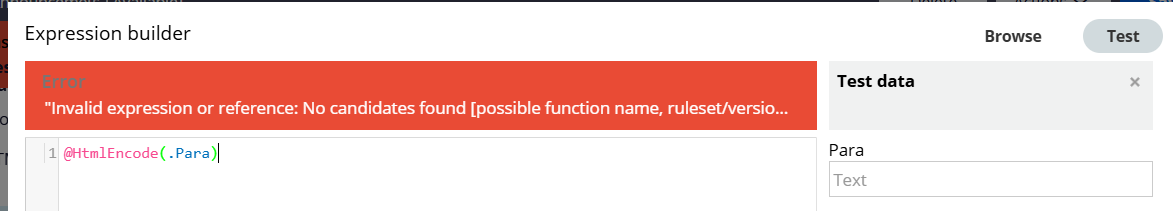

@B Anurag To display HTML content stored in a property inside a Paragraph rule in Pega, you can use the @HtmlEncode() function to safely embed the property and avoid breaking the HTML structure. However, if your goal is to render the HTML as actual content (not as plain text), Paragraph rules do not directly support rendering dynamic HTML stored in a property. Instead, you can embed the property in a section using a Rich Text Editor (RTE) or a Read-only Text control with the display type set to “Rich Text.” This will render the HTML content properly. Ensure that the property type is Text (not TextArea) and that "Allow HTML" is enabled in the control settings. Paragraph rules are mainly used for static content, so dynamic HTML rendering is best handled through section rules.
@SairohithUsing propertysethtml in activity im storing the html code to one property , Which ui control is richtexteditor and this property is showing the raw html code in the output, as u suggested to use the function @HtmlEncode() which is giving error
