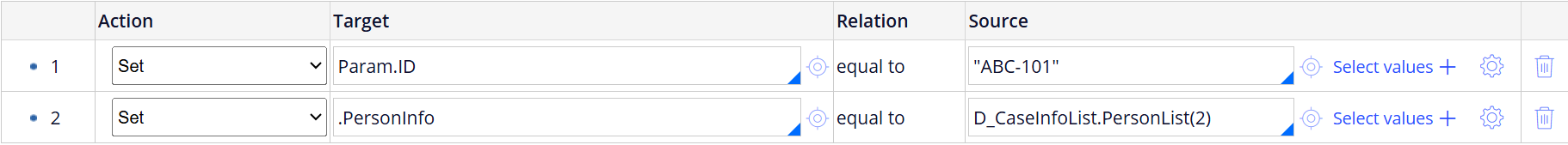

Hi @MaxonL16591286,
I tried re creating the error you have shared and have implemented below step
But I'm not able to replicate the error you are getting instead its working fine for me. Am I missing something?

Hi @MaxonL16591286,
I tried calling same from flow post wait shape as well, it is working fine for me.
But I have seen such issues while working with waits, as the system completes the wait the following action post wait doesn't get the proper context sometimes.
Try moving the DT to pre action if you have an assignment shape after wait, if not try adding a router utility(toworklist) after wait shape which will reset the context.
Hope it helps!
